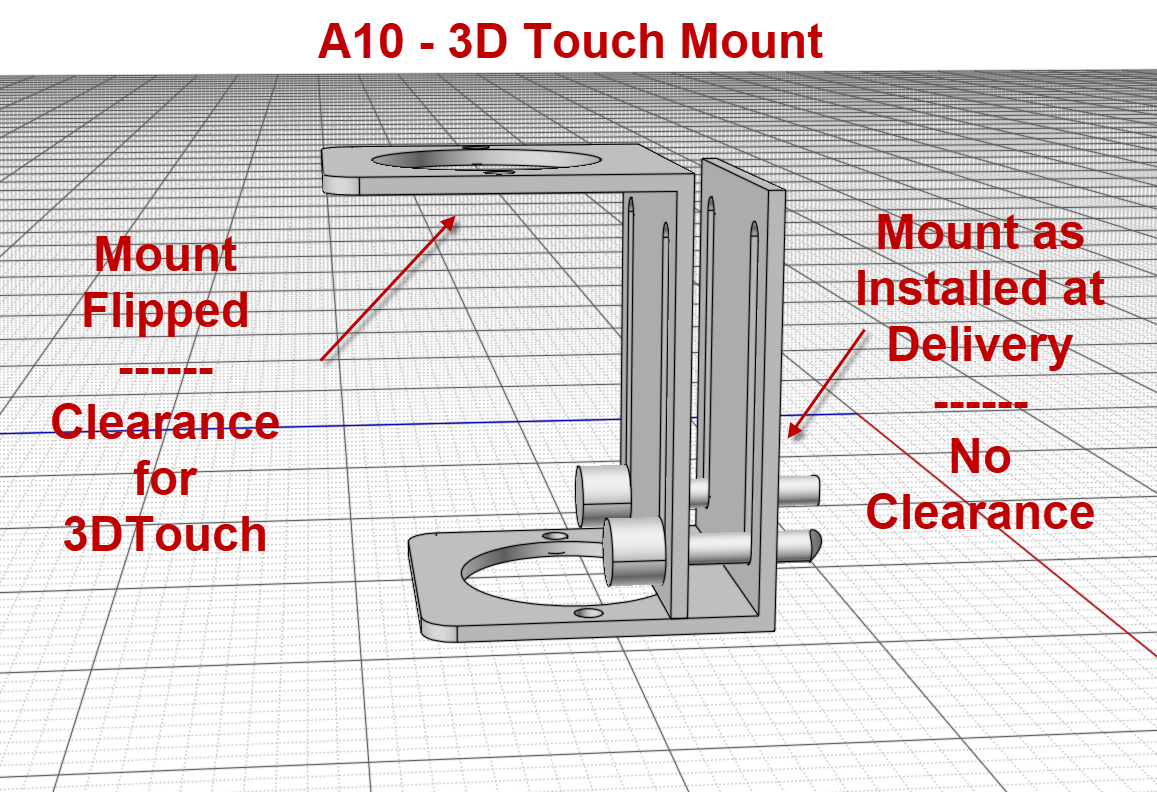

We have found that the A10 mount for the 3DTouch and BL Touch had to be turned over to provide the needed positioning.
As shipped, on our printers (4 so far), the mount was shipped with the flange down limiting vertical height.
We reversed the mount so that the mounting flange was at the TOP and we could set the proper position for the 3D Touch.
