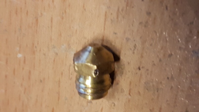

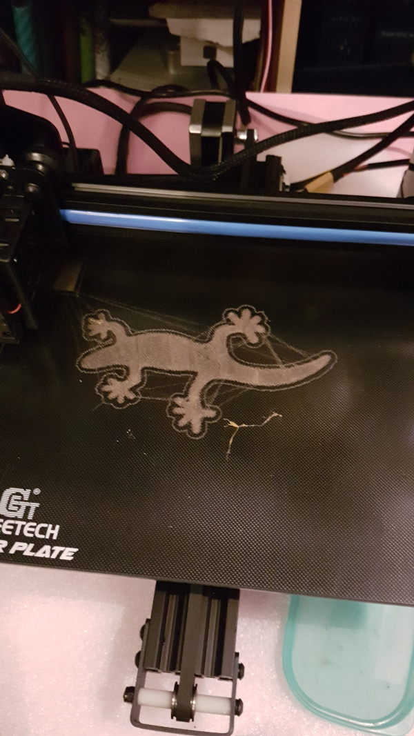

Even after levelling the bed (wrongly i think), my first print destroyed the nozzle and the Bed !! (i now have a splendid drawing of the lizard on my plate .. check pictures).
So now, i want to buy a new nozzle, but i'm confused. I notice that A10M can only use one type of nozzle, but the ones sold by Geetech for A10M seems completely different as mine.
Mine seems to be more like A10 nozzle.
Can someone confirms that i can purchase A10 nozzle for A10M printer ?

Re: Extruder nozzle for A10M
Apparently the nozzle was changed from 9 mm to 12 mm and seems to be working better than the first version.
Just make a search on this page and you will find the correct model for $5 or so.
More info here
http://www.geeetech.com/forum/viewtopic ... 08&t=62126
There are also some very useful hints that might help you
A20M is very similar to your A10M and has the same nozzle
A10 Nozzle does NOT work with A10M !
very beautiful picture of the Gecko by the way, I would think about framing the old plate
