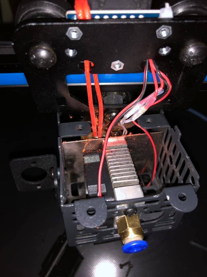

The other day I noticed my hotend wires are frayed and fraying and getting a red dust all over. I posted in the Facebook group, but it was during the New Year so no one was around.
Also, in that picture it looks like one of the hotend wires goes through the hole made for it, while the second one goes underneath.
I've not had this printer for a month yet, and it's been nothing my problems compared to my, now custom, A8.
I can't print anything longer than ~60 minutes with any type of success, more often the prints fail sooner than that. The most frustrating part is when the hotend fails, the print keeps going so my extruder just sits there until I see/notice it clicking away trying to shove cold plastic down the hotend.error nozzle 0-temp the heating element is out of order

If you have an insulation tape, try wrapping the wires in the contact point where they pass through the hole.
