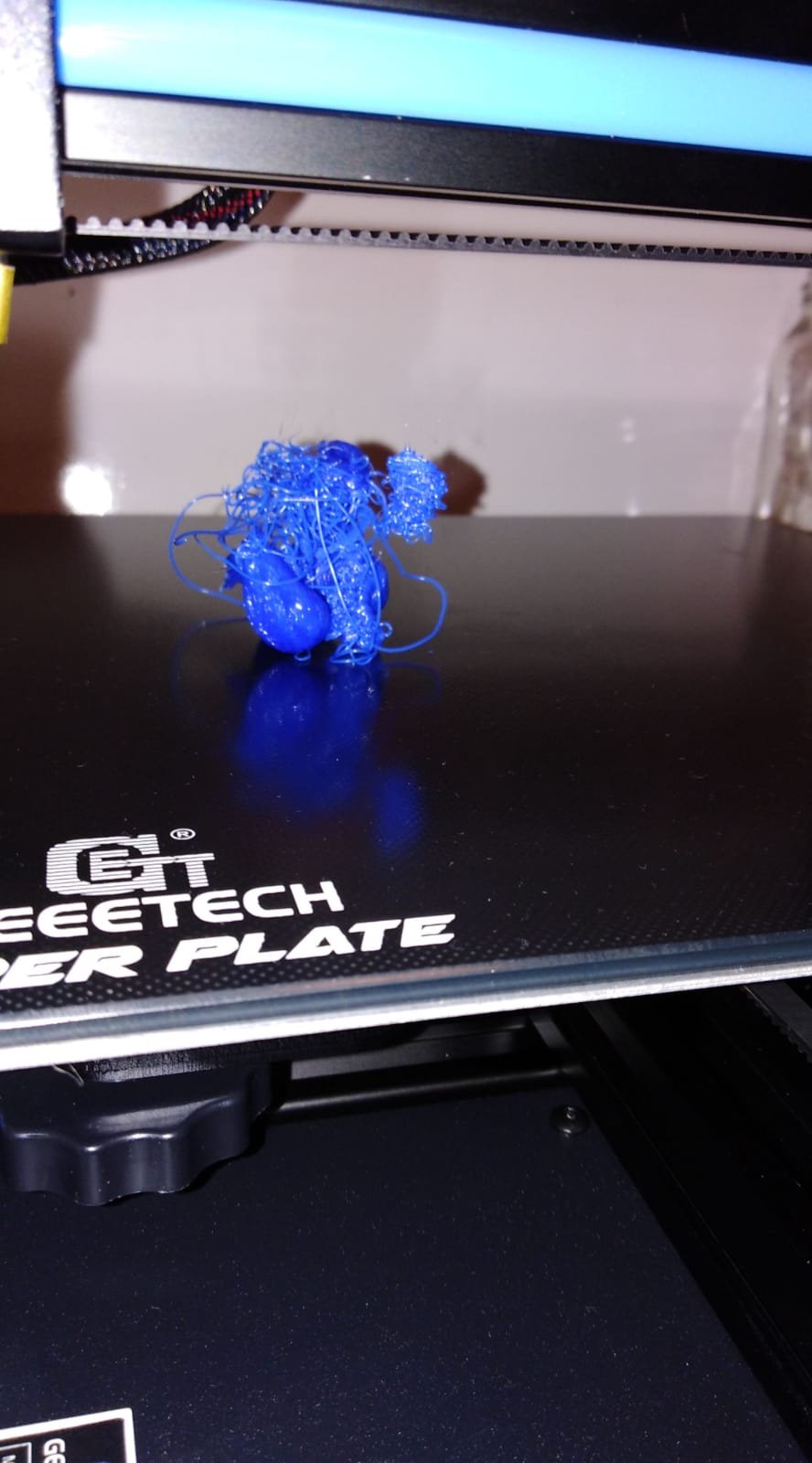

All of my prints end up like this.... Why?
abssalom
Posts: 5
Joined: Tue Feb 26, 2019 10:57 pm
Post by abssalom »
I have a Geeetech A10 since yesterday, and i cant print anything... All of my tries end up like this...
WhippingBoy
Posts: 27
Joined: Sun Nov 11, 2018 4:25 am
Re: All of my prints end up like this.... Why?
Post by WhippingBoy »
You need to monitor the first layers to see what happens.
It might be a bed leveling issue. 😉
lorjavier
Joined: Sat Mar 02, 2019 4:30 am
Post by lorjavier »
Check the material flow in EasyPrint /Settings/Slicing settings/Material/Material flow is at 100%
I think you should check the hot bed leveling at first.
It seems the leveling have a big problem.
