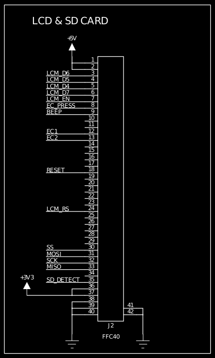

The power supply circuit is built as follows:
1. main power supply.
2. a small 5V DC converter on the controller board.
3. the 5V power supply is transmitted via an FFC cable to the LCD module.

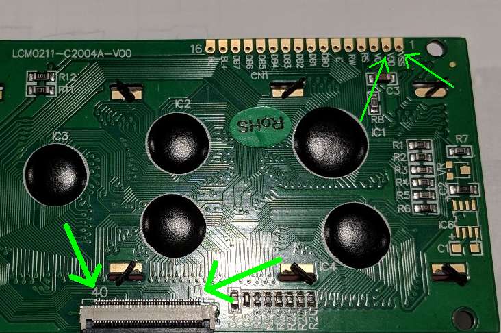

On the picture there is a part of the circuit diagram with description of leads on the connector to the LCD module. Outside pins are power supply voltage.
Make a measurement here.
Next measurements should be made in places where I draw arrows.

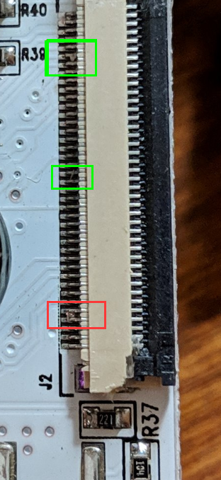

My GT Team friend Tom has found two disturbing places in your photo.
I marked them with a green frame.
Could you check if the pins are not short-circuit

Confirming the photo of the control board display connect with solder over lapping. I can't get in there and melt away the solder. Is that our culprit?

The black image is a piece of a circuit diagram, where all signals in this connector are described.
We are only interested in power supply, at the outermost leads.
I must ask you to measure them with a multimeter on the controller board connector when the LCD module is disconnected.
Next, on the connector of the LCD module when you connect it with a cable.
The last measurement was to be performed at Vdd and Vss points. In the following way - the first test tip of the meter to the VDD potential and the second to the VSS potential.
The short-circuit you have found can be removed by cutting with a thin blade. Soldering at this point will be very difficult to do, even for me.
However, I have special soldering substances that help with it.
