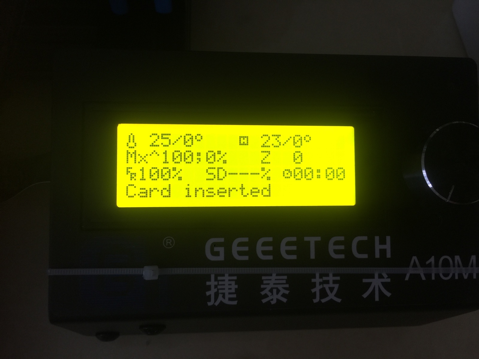

I still can nnot see A10M using USB with driver instelled on MacBook.
- IMG_6157.JPG (306.47 KiB) Viewed 9703 times

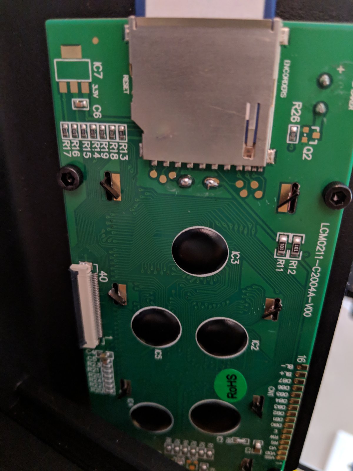

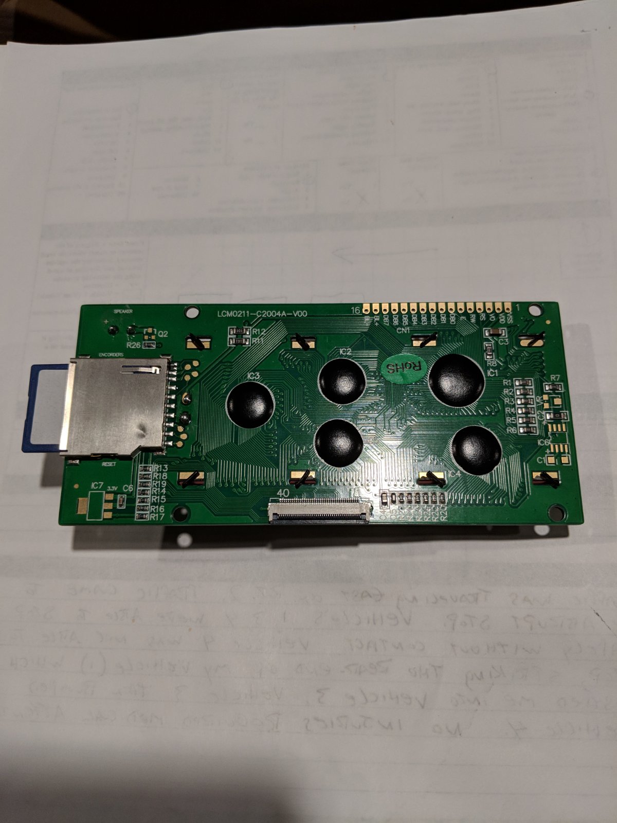

Do you know where I can buy a new display? I need the display with a flat cable. See photo. Should I buy the control board and display combo? I have the GT2560 V3. Time to either print or return this unit.
- MVIMG_20190216_132603.jpg (239.2 KiB) Viewed 9688 times
- MVIMG_20190218_174039.jpg (249.31 KiB) Viewed 9688 times
Re: New A10M display
Hello.
Okay, I understand that you are no longer interested in finding an error. I understand it.
You can always write a message asking to buy new components to sales@geeetech.com.
Describe your situation. Write in a message what printer model and controller board version you have.
I think there is a problem with your display module.
