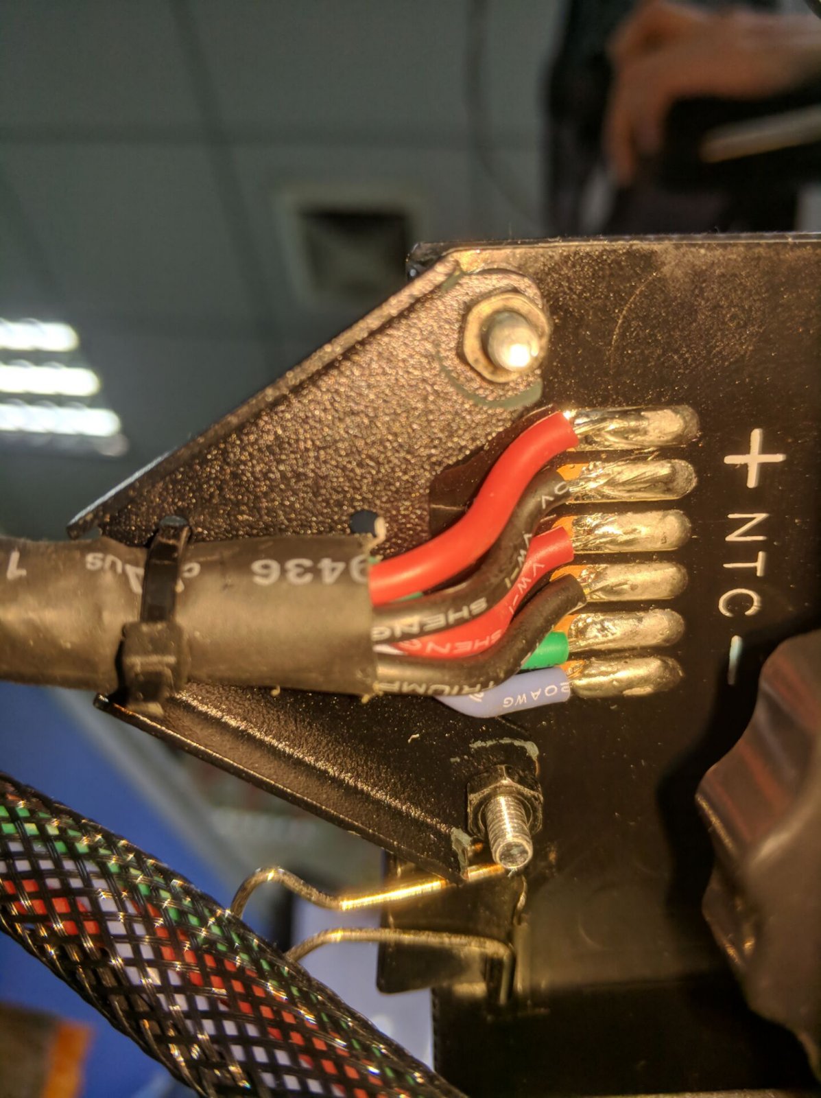

2. As you remind us the LCD shows the abnormal temp info
I think you should check the cable lines of the hotbed
A10 Heatbed v1-1.jpg (255.65 KiB) Viewed 10443 times
A10 Heatbed v2-1.jpg (198.59 KiB) Viewed 10443 times
