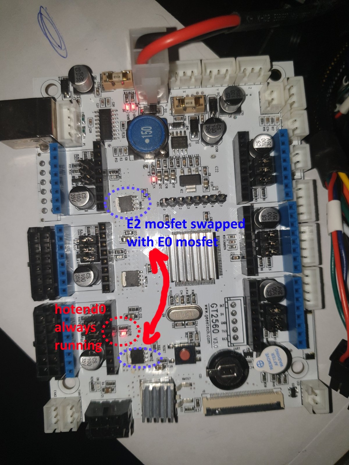

thanks for your reply. The Hotend shows always 24v, even if the print was not started.
I already changed the E0 mosfet with the E2 mosfet, because the port is not used, but i had no success. It has the same behaviour. The Led of the Hotend is always lightning and hotend gets constant 24v.
Everything else i can do?

- 20190312_091826 klein.jpg (317.62 KiB) Viewed 10927 times

It seems the MOSFET is ok.
Then you can refer to it:
The led light means it gets the PWM2 signal.
Refer to it:
https://github.com/Geeetech3D/Diagram/b ... .0_SCH.pdf
1.You can re-upload the firmware for it
2.You need to ask the sales send you the new GT2560 V3 board(The chip of MEGA2560 broken)
