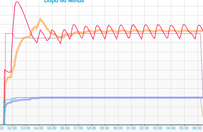

- Posts: 6
- Joined: Thu Oct 11, 2018 5:55 am
Re: Unstable hotend temperature
Hello Wiliam,
i tried restoring to default, no difference,
i tried any kind of PID parameters, no difference
Edit... actually now it goes very high only at beggining, then it oscilates for only +-1° which is cool i think.
I did restore default before and it did nothing, not it seam pretty much OK.
Thank you very much
Thank you very much

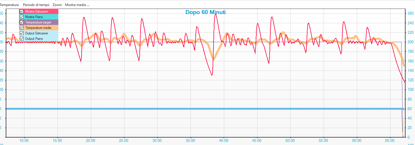

- Posts: 6
i was too quick on giving answer to Wiliam, and too quick to edit it.
after running a few hours print this is result.
First the temperature went very high, but soon stabilize to normal print temperature, but after about one hour, it started oscilating again, and at some point temperature just droped down to death.
From starting the print, there was no manual changing of any parameter, i clicked run, and never touched the printer.
- Cattura.PNG (46.02 KiB) Viewed 5931 times
Hi,DaliborBalic
You can try to update your fw to V1.38.59 at first.
Then set the PID for it again.If you have set the PID but it the issue still on.
You need to check the PSU+ mosfet at first.
If the PSU has an issue then the printer won't work normally.
Or you can try to check the mosfet of the E0 with the multimeter.
