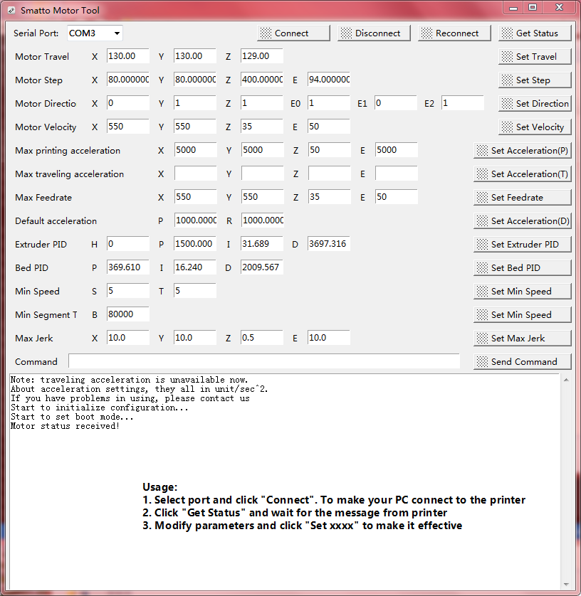

You can use the V1.1 or V1.2 to change it:
https://github.com/Geeetech3D/Smartto-T ... plications
NOTE:
Added more options to further
smartto_motor_tool_1_0_forWin.zip
(7.32 MiB) Downloaded 1777 times
Update:
Don't need click "factory default".You need to set correct vaule then restart your printer.

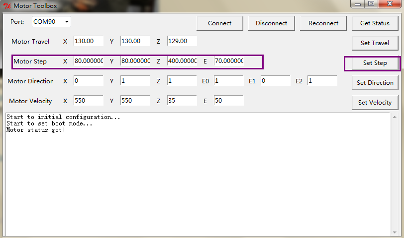

Here I will show you how to change the steps/mm.
MotorController.rar
(7.26 MiB) Downloaded 1682 times

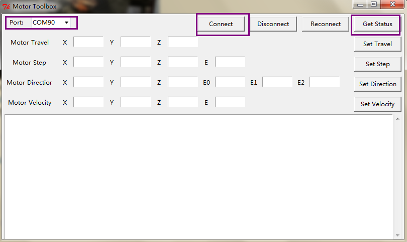

1. First you need choose the right port
2. Click connect
3. Then get status.
then you will get the parameter.

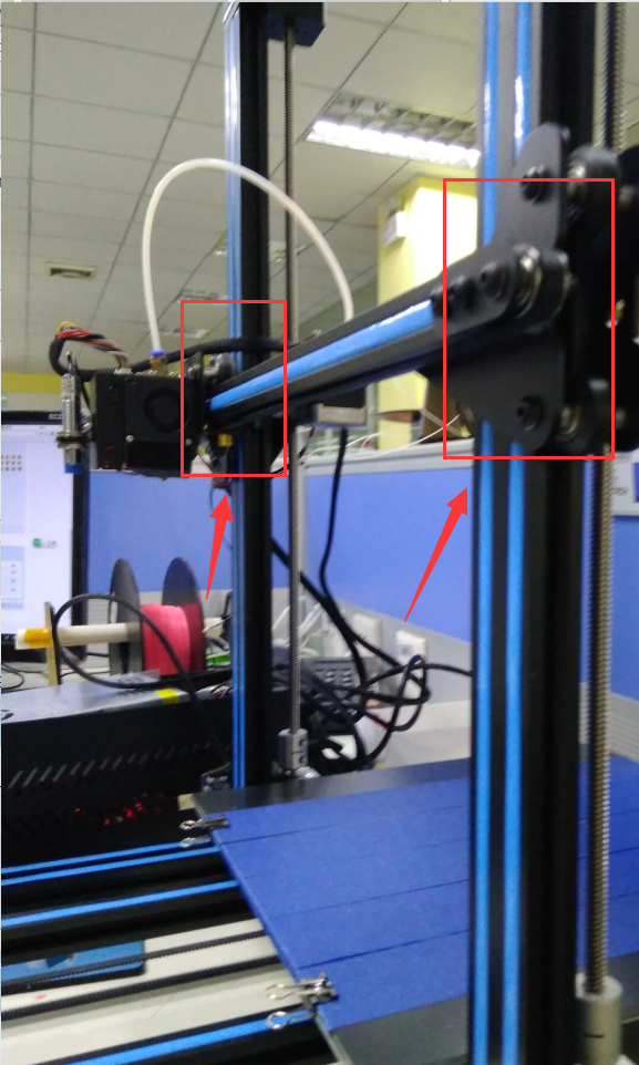

Change the direction of the motor
You should ensure X axis stop at here then change the value

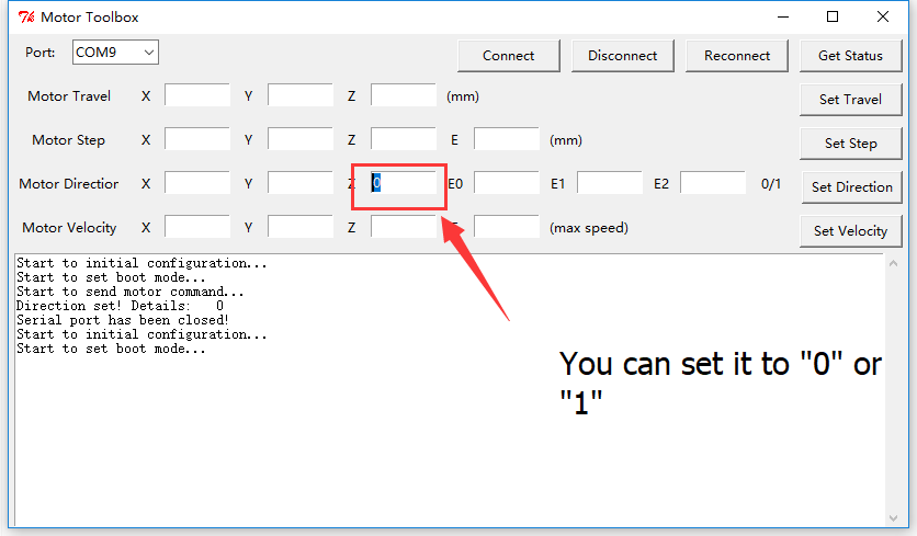

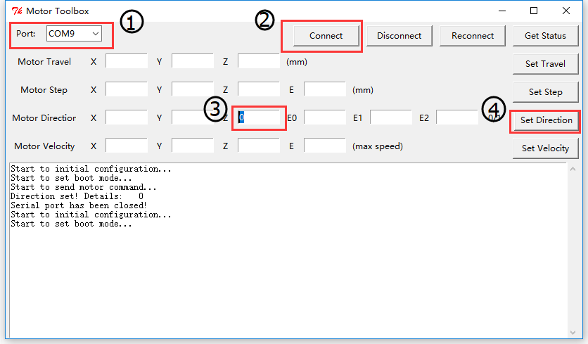

2.Refer to this pic and set the correct value
You can change the direction of all axis and extruder motor
As mentioned above, set it to "0" or "1"
