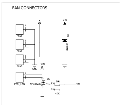

Section with fan sockets.
All sockets have 3 outputs.
In this case, you can connect a fan with two wires: Vcc and GND
and three wires: Vcc, GND and Fan Tach.
Correspondingly, the colours are: red and black and yellow.
Note that only two signals are connected in the diagram. Fan Tach signal is omitted. If the fan is equipped with it, it generates two impulses per full revolution, to be counted by the controller.
This still has nothing to do with the PWM.
Now look at the socket at the bottom of the drawing.
There is a small addition in the form of the N-Channel Power MOSFET transistor.
It does nothing else than cyclically power the connected fan.
This is done in tact of the given PWM signal, on the GND line. ;)
Forgive my little technical language but I tried to write it straightforwardly so that it would be understood by a larger number of users. 8-)

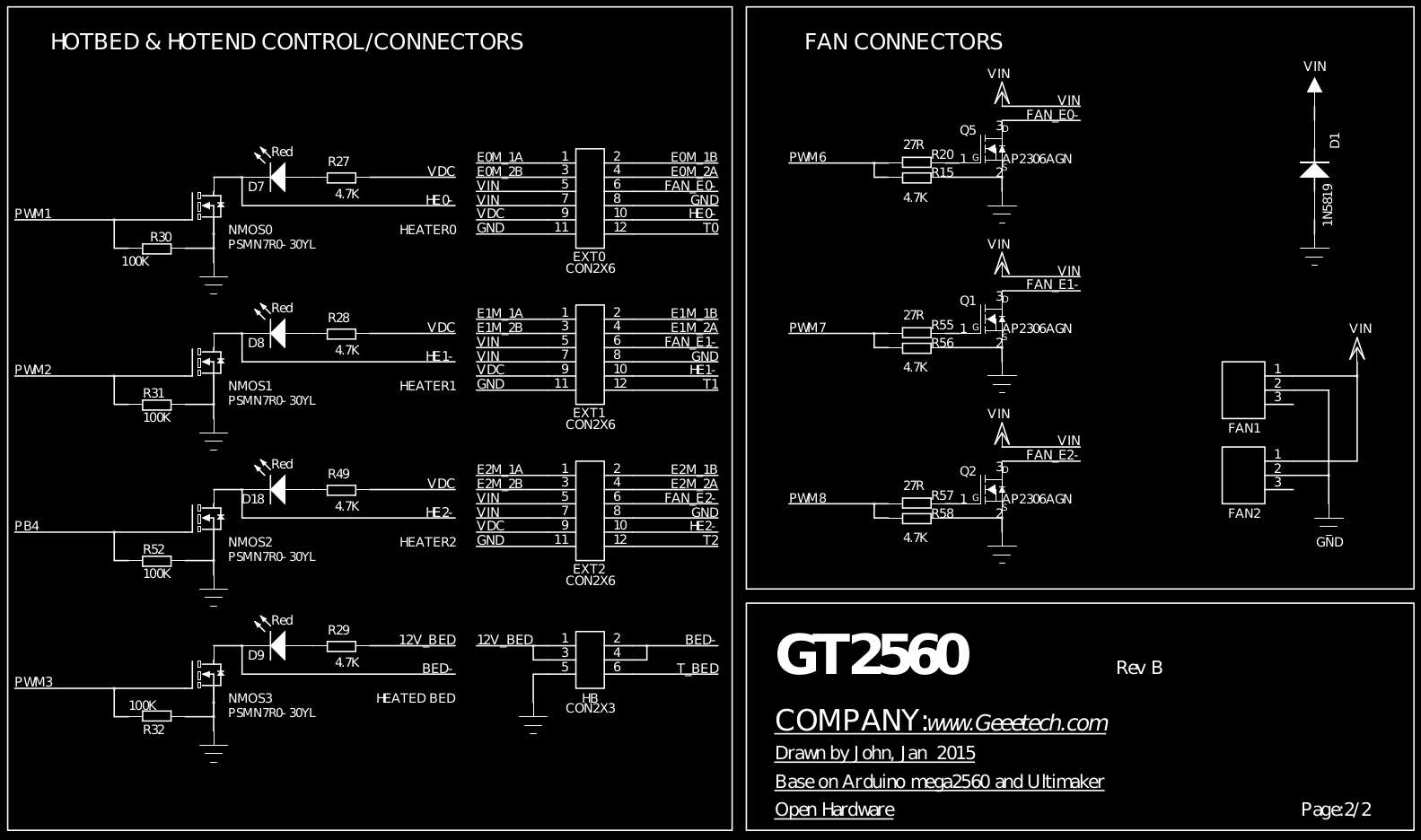

I asked about three wires because you gave more information than apparently was necessary and discussed 3 and 4 wire fans.
I am having difficulty finding schematic with labeled connections for gt2560 revB...it looks much different than revA from I see. Cooling fan is bundled with many more cables into one big connector, instead of individual fan connector. The fan is labeled on its back 24v...from youtube video and description of revB board on geetech site, the pwm output is only 12v. This is why I believe fan is weak and will not run on anything but S255.
Perhaps putting correct 12v fan on machine will lead to full pwm control.
Does this sound reasonable solution?
Thanks
_kaktus_
Posts: 1259
Location: PL
Contact:
Re: Fan problem during operation.
Post by _kaktus_ »
Hi
:mrgreen:
In my opinion, you have discovered the reason for the complication.
Applause for independent work. :D

I have a surprise for you.
:mrgreen:
Fan connectors & ...
