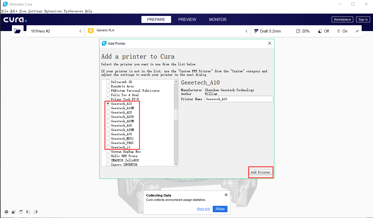

Are you can't find Geeetech i3 on Cura?
Don't worry
Refer to these:

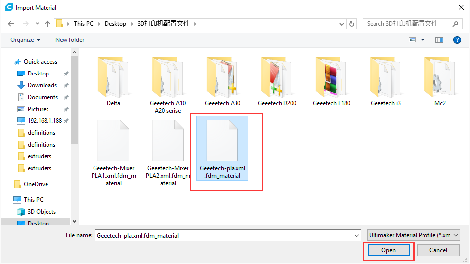

Download the PLA filament profile for A10M
Geeetech-pla.xml.zip
(932 Bytes) Downloaded 2669 times

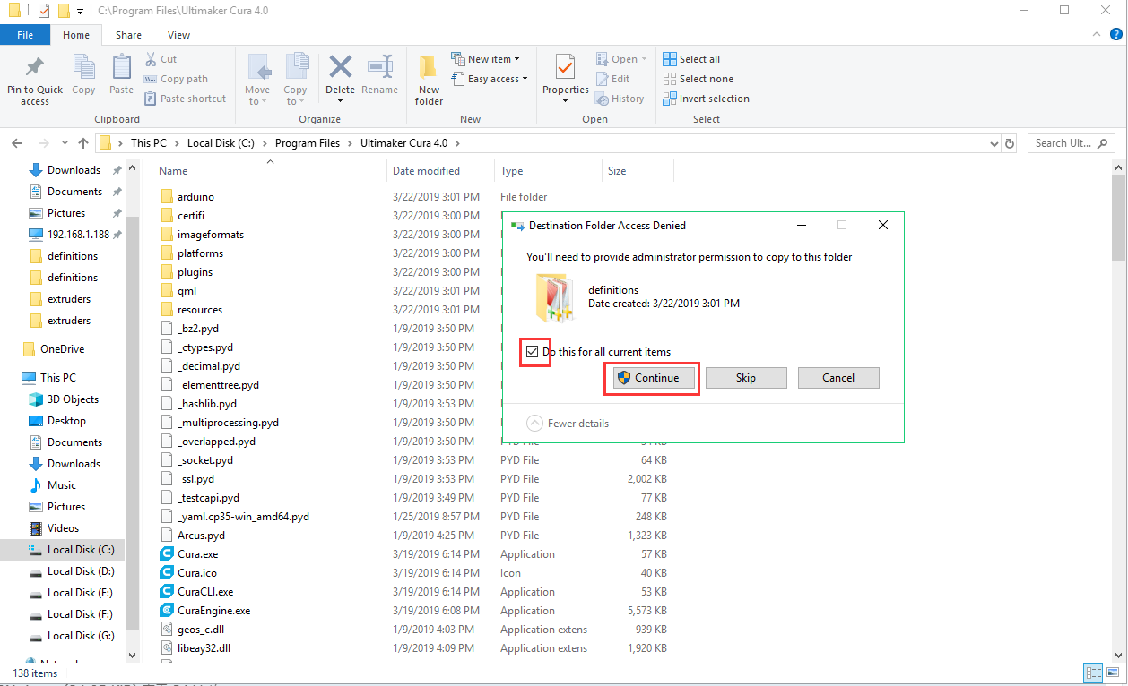

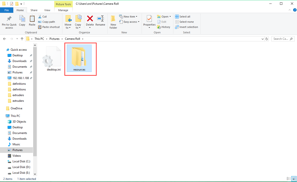

2. Unzip the zip file then you will get "resources"folder

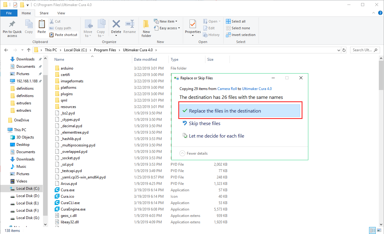

3.Copy "resources" to the
Cura installation directory
Default:
C:\Program Files\Ultimaker Cura 4.0

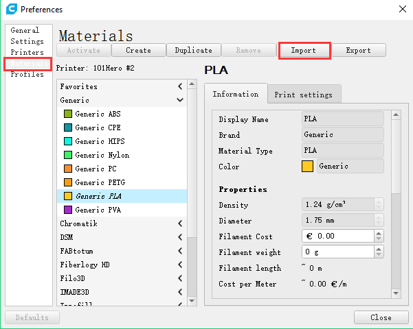

3.Import the PLA filament profile for Geeetech A10M
4.Done!Enjoy it!
