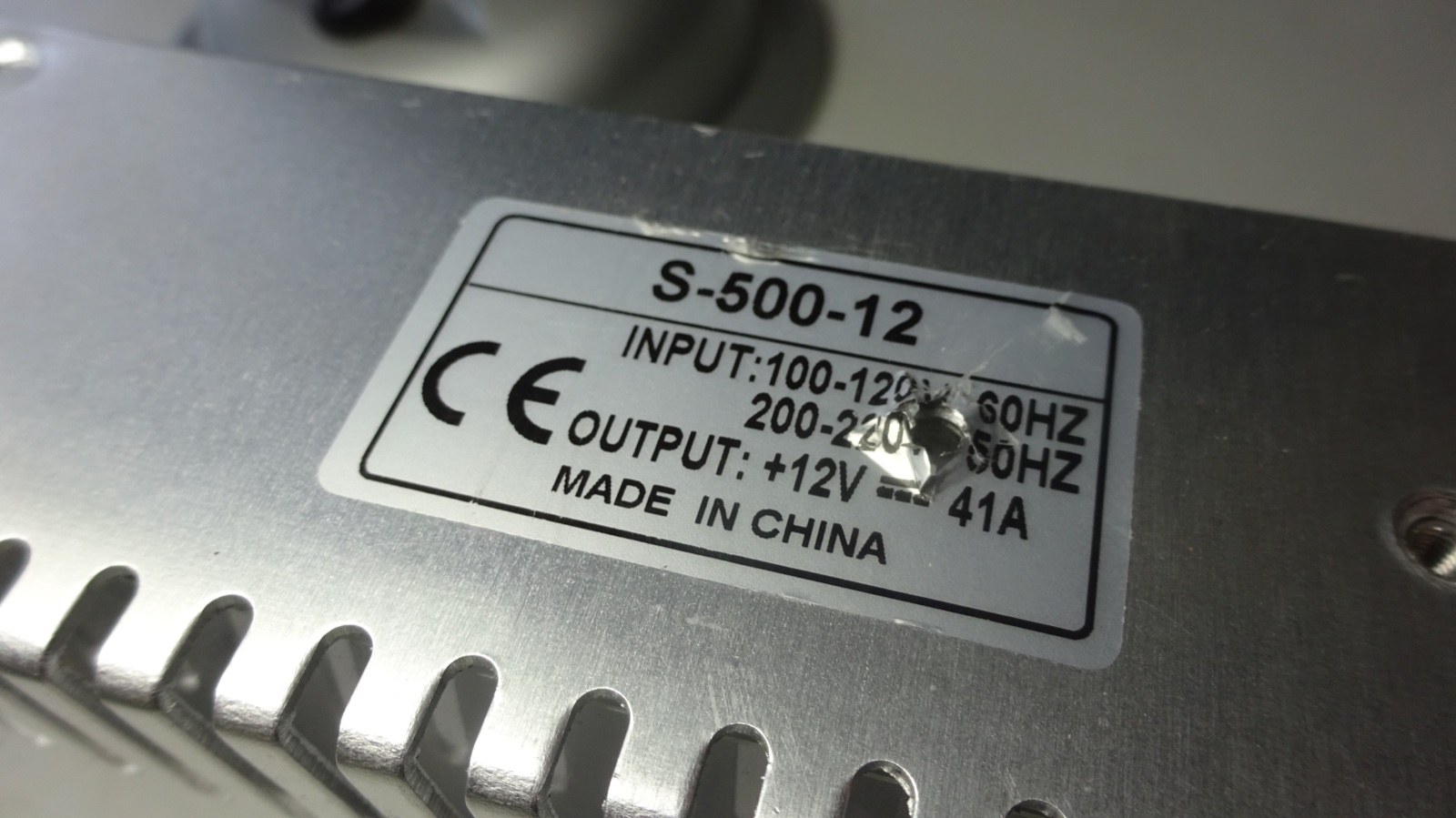

One resistor (R23) has no leg
I cared more about the outer photo. Especially in a place with a label. To see what it is.
Geeetech filament, ABS only
Re: Printer heating bed switches off
that's right, R23 only has one leg left. Also R28 is broken. For the white material on the electrolytic capacitors, I first thought that one of the capacitors had burst, but it is probably an elastic adhesive. But during the desoldering, I noticed that there is a cold solder joint on a connecting leg (both capacitors are ok.).
Here is a picture of the type of PSU.
- PSU2.JPG (330.95 KiB) Viewed 8701 times

This is a budget version, which is worth avoiding with a wide arc
Yeah, it's white. It's glue. Its purpose is to absorb mechanical stress, and it will keep large elements in place. In this way, the leads will not be torn out of the component and PCB.
