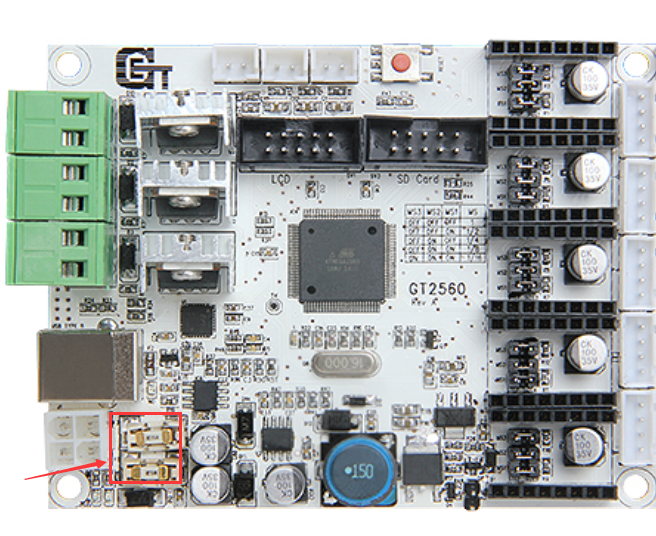

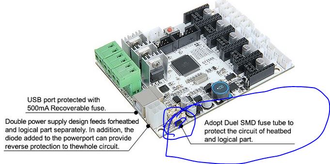

Re: Screen error
pls see attached image, is this the fuse marked in blue?
- Fuse.JPG (58.04 KiB) Viewed 7061 times
Re: Screen error
I've checked your info and now I know what you want to ask.
Here is the fuse:
Here is the fuse:
