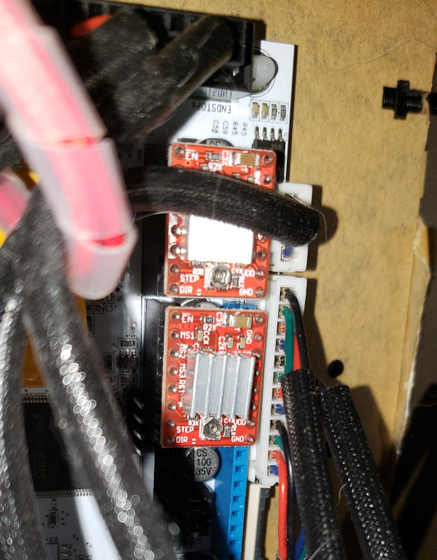

Thank you for taking your time to help me problem solve, I also apologize if my questions are dumb lol (completely new to all this). Attached below is a image of my wiring. I understand it is very easy to mess up the wiring. But the 3-1 wire can only connect one way onto the motherboard, so there isn't room for much error. Only thing i can think of is if the wires to the stepper motors are wrong.
On page 74 of the assembly instruction manual (where i downloaded from http://www.geeetech.com/forum/viewtopic ... 77&t=62088) it shows the wire configuration as (Z-Y-X) which is the configuration that i have mine at.
on page 76 though it shows (X-Y-Z) which i can't try since the plug wont fit that way.
I have the Z wires attached to both stepper motors on the bottom. X wire attached to the stepper motor above the left Z motor. Y motor attached to the stepper motor controlling the movement of the base plate.
At the moment this seems to be one problem i don't know what i did wrong. I also have another problem of the Z axis still being stuck but from digging around the forum i believe i can figure it out. Just need to fiddle with it and try all the solutions. I just don't understand why the x- axis won't move.
I don't know if this is maybe the cause but when assembling the printer. When I tried to turn on the printer for first time it wouldn't turn on. Till i saw a tiny switch on the power supply indicating "220v and 110v). I turned it to 110v and the printer turned on. If set on 220v the printer will not turn on.
- PSX_20190311_172948.jpg (154.78 KiB) Viewed 16853 times

OK. You showed a photo of the connector in the motherboard. Compare the order of colors at the other end of each cable.
The errors are due to poor quality control on the GT side. It's difficult for a new user to grasp them. This is understandable, after all, everything is new for him, and he trusted his manufacturer ...
https://imgur.com/YeMyN8q
https://imgur.com/189WClq
https://imgur.com/Rm8JqaJ
https://imgur.com/eABXJHh
Don't blame yourself for nothing, just be very attentive, consistent and persistent
The author of the subject which you linked did not find an error in the order of the cables in his plug. Maybe you will try to catch it
This will be a good test for you. Learn from someone else's mistakes.
Consider doubtful everything you see in your model. Compare the view carefully with the photographs on the M201 subforum.
I can't see one stepstick module in your photo.
It should be embedded in this empty socket.
