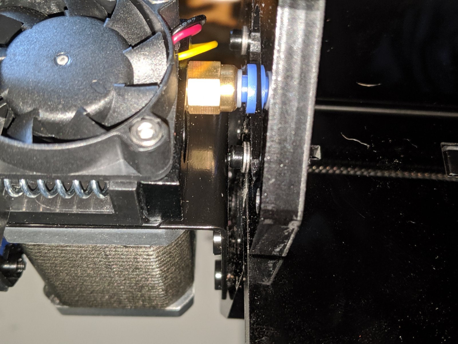

So when I go to mount the extruders the holes pre drilled leave the bracket setting on a mount screw. Am I doing something wrong?

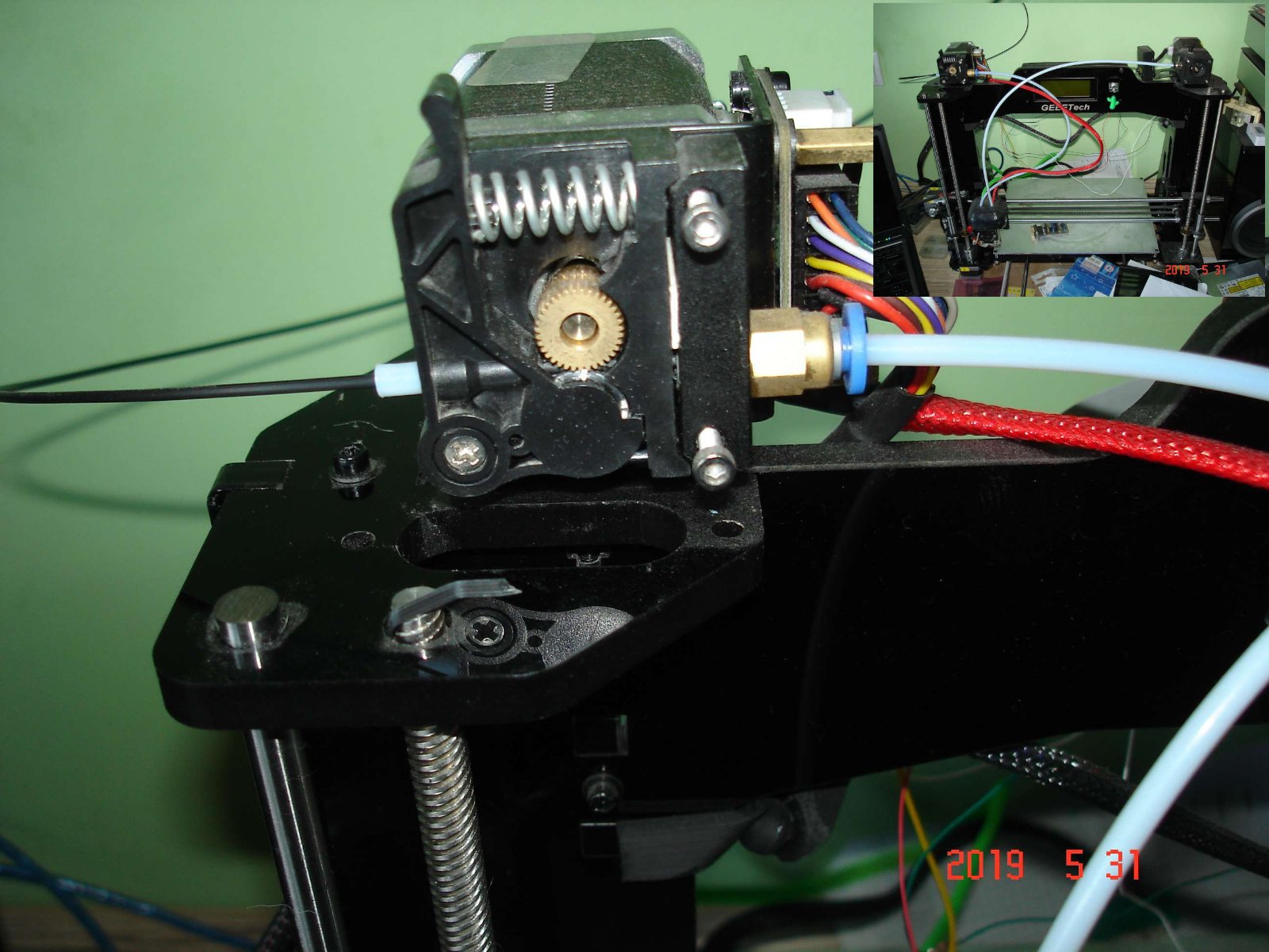

Look how I did it.
This assembly resulted from my observations and reflections.
Bowden tubes lay more freely when printing. There are no such big bends. Each bend in the tube leads to a narrowing of its diameter. This in turn leads to a greater difficulty for the filament that moves inside of it.
