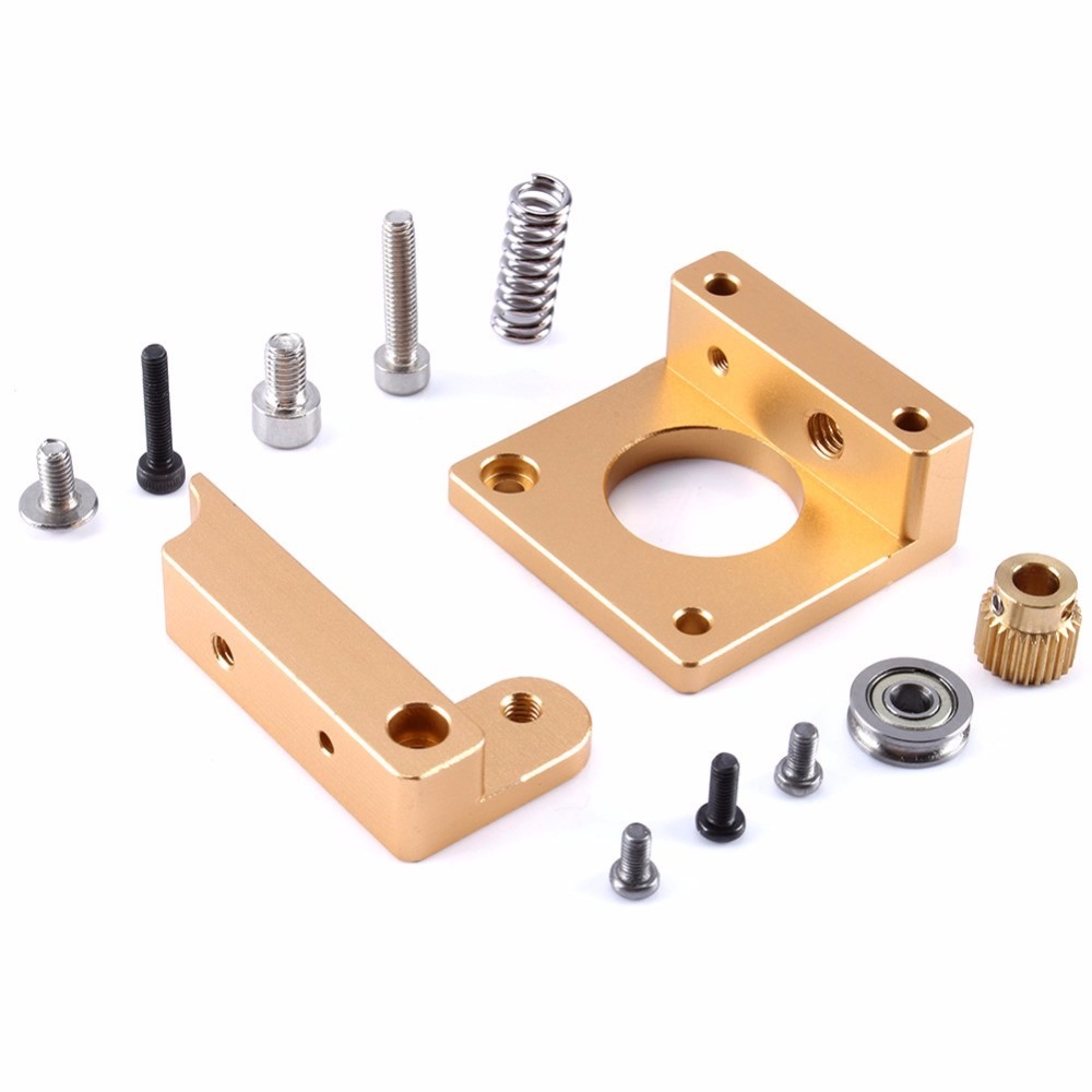

I bought two of this on ebay and they work without any problems.
- 1.jpg (85.64 KiB) Viewed 6826 times
Re: Metal/Alu extruder feeder
Looks very simple and smart. Perfect, I will try, thank you!
I agree. i own the one slipknot28 posted. For PLA it is fine but im going buy the BMG dual drive.
