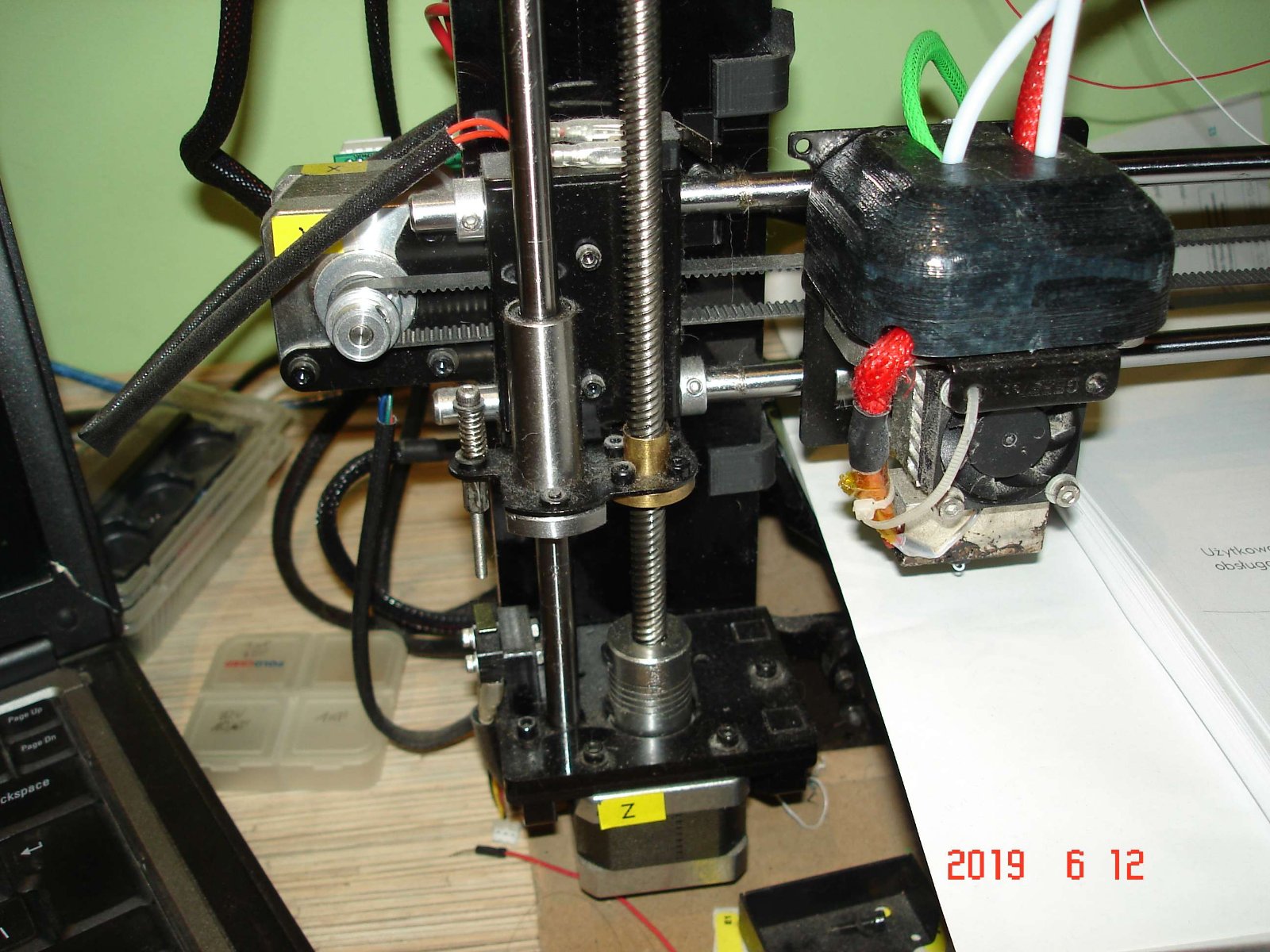

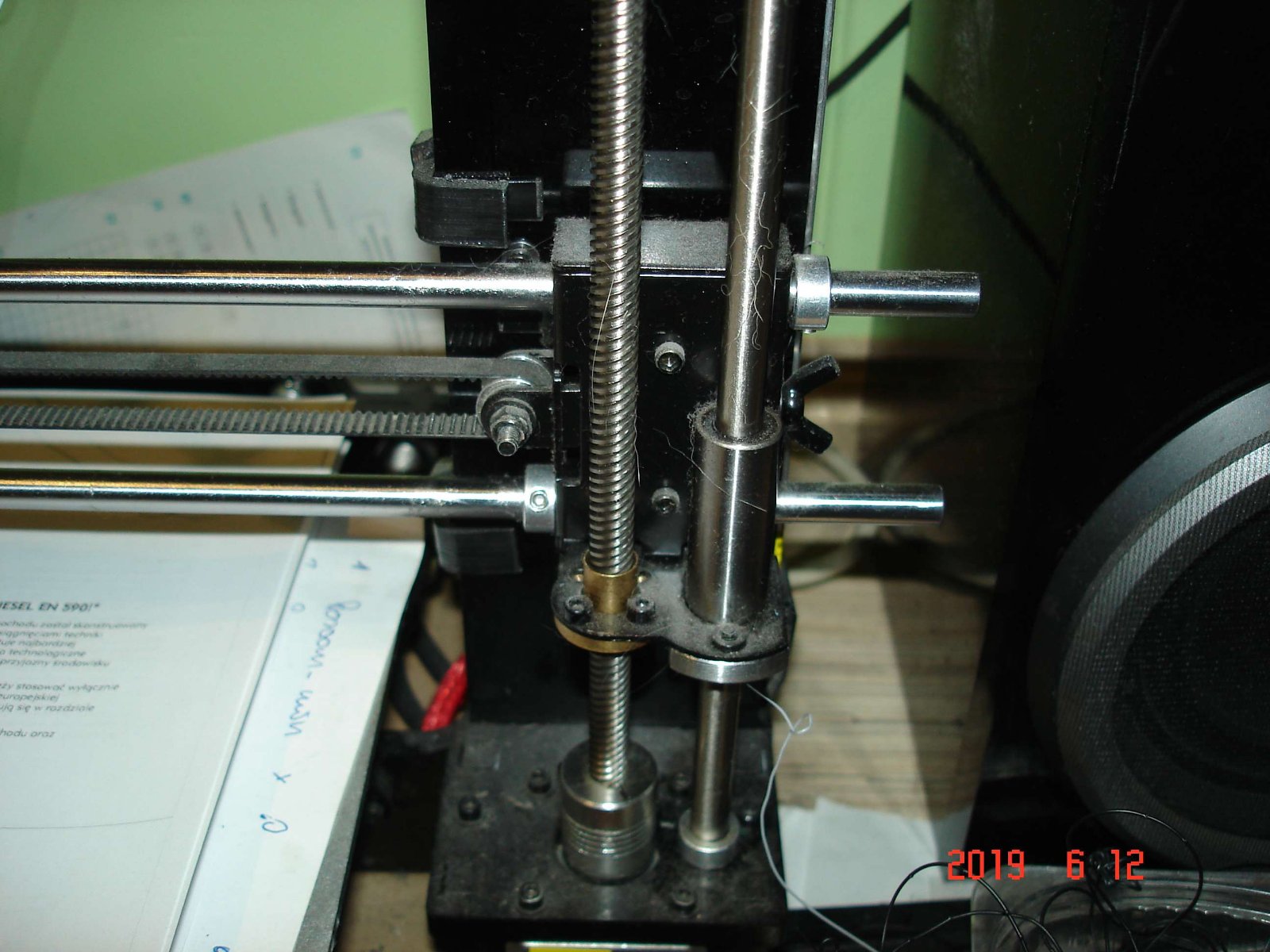

I'm posting two pictures maybe they'll help you.
I recommend that you read everything in the subforum of the M201. ;)

I read and reread everything in the M201 area before I posted. Am using it as reference. Much good info. Yes, those pics show where some of my problems lie. those two "boxes" do not hold the x axis rods perpendicular to the Z axis. Also the bearing and nut mount area is not true to anything. When bolted tightly, it seizes up. Am trying to setup a way to square & true the boxes. But they are bent metal, not a lot to work with.

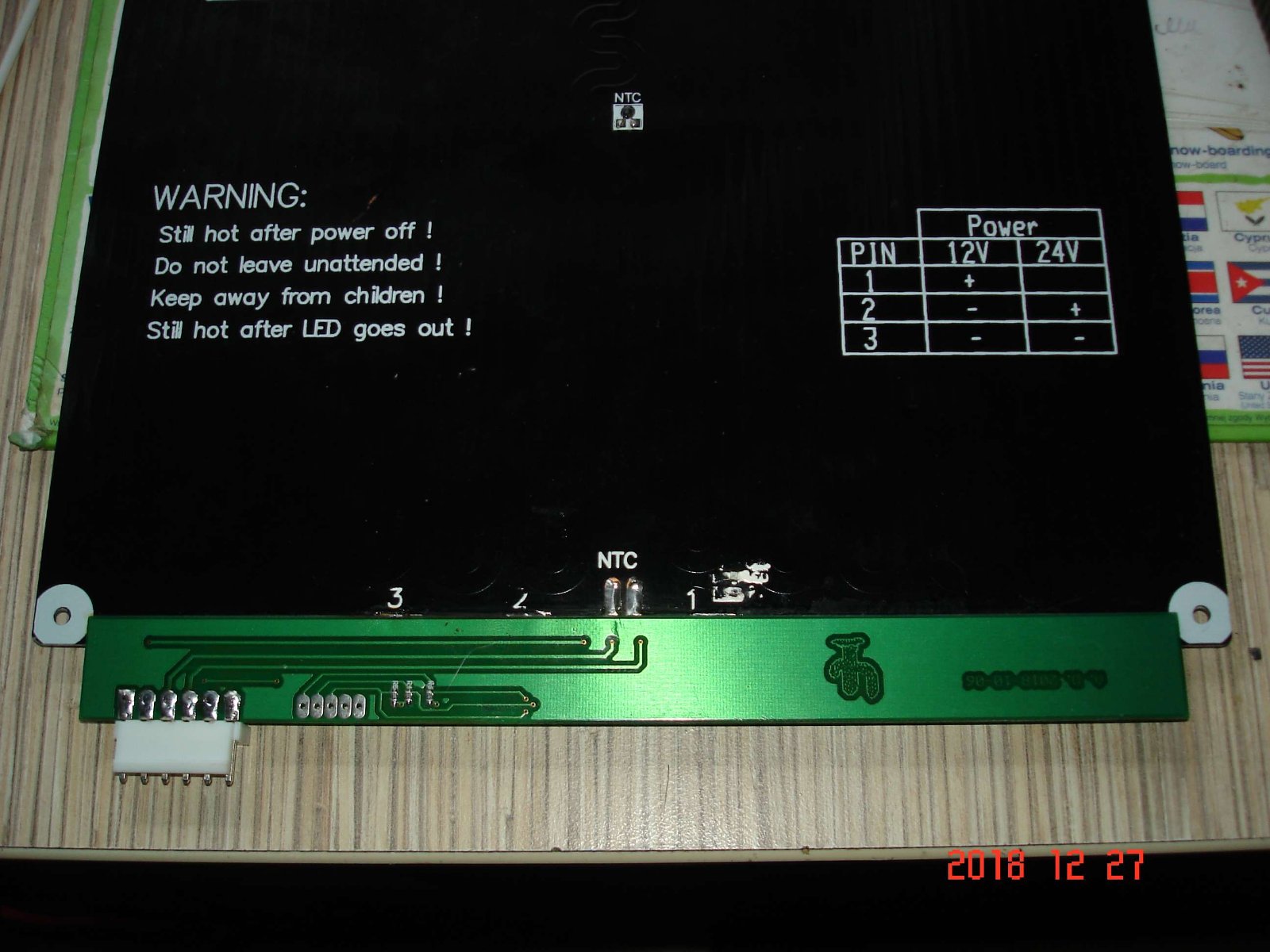

But I once started such a project:
This is a GT "Geeetech Superplate 3D Printer Aluminum Heatbed Kit" with adapter for our printer + surprise. :mrgreen:
