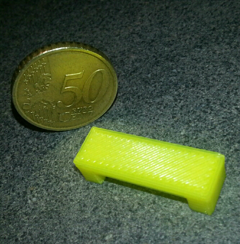

I mean for layer height = 0.1 mm.
I've attached now the results that I forgot in my previous post

- IMG_20150324_070435_20150324071332720.png (551.43 KiB) Viewed 6413 times

Re: Printing Quality
Usually, the first layer height equal nozzle diameter.
You can see more details at this page:
http://manual.slic3r.org/

I redid my entire calibration of the XYZ and I am still having a problem printing a test cube.
It looks like the problem is on the x-axis. The pulley's are tights and the belts are as tight as I can make them without them causing the extruder to start skipping.
Perhaps the filament does not stick to hotbed. Please try to smear a layer of glue, or spray a layer of hair sprayer.
