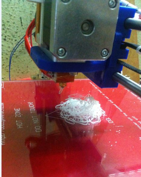

Greetings,
Finally, when I was able to print. i got a very bad quality printing.
I used the setting that you share for Printer I3 B, ABS 1.75, nozzle 0.3 as default when buying.
the picture below is talking:
I used Temperture trying from 240 up to 255,a and 95 up to 110 for hotbed
the problem is that the filnamnet is not melting very well and not going out from the nozzle very well, and then not stucking well on the hotbed.
I tried to clean the nozzle,, but still the problem not solved.
Please help to solve this issue, because i spent alot of time trying to run the printer in good condition.

zhangxueyou
Posts: 1405
Re: Bad Print Quality
Post by zhangxueyou »
Hi, you can smear a layer of glue if the filament can not stick to hotbed.
And you can refer to the slicer settings at this page:
http://www.geeetech.com/forum/viewtopic ... 14&t=16366
