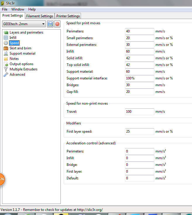

Hello,
i haven't tried these settings yet. but would this help with the bumpy look? so far my prints have been not so great. i would like to print a design but if its going to be bumpy looking its not going to work with my design. how can i go about doing a fine slow print where i wont have bumps on the print?
zhangxueyou
Posts: 1405
Re: My slicer settings
Post by zhangxueyou »
Jsantos1214 wrote:Hello,
When printing, you can rotate the knob on LCD anticlockwise to lower the speed, you can see the percentage on the thirdline of LCD.
You can also set the speed in slicer setting:
FLeeX
Posts: 4
Joined: Thu Apr 21, 2016 11:02 pm
Post by FLeeX »
zhangxueyou wrote:You can also load the configuration file too.
slicer config.zip

Tell me please why the settings are totally different compared to those files you uploaded here? It's all different between this "Slicer config" and "Slicer settings", I don't understand lol
