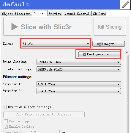

How to access slicer setting and slice:
Open Repetier-Host, click "configuration" under "Slicer" tab:

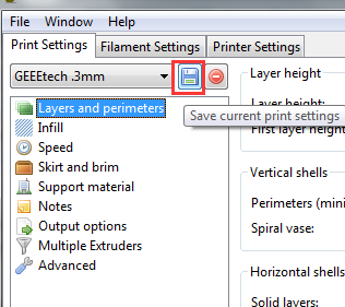

Save change after you change every group of parameters.
save parameters.png (22 KiB) Viewed 71202 times

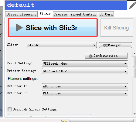

Click "slice with slic3r" to generate g-code:
slice with slic3r.png (15.88 KiB) Viewed 71202 times

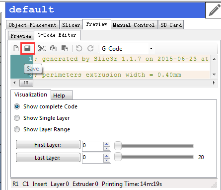

You can save the g-code in SD card to print off-line:
save gcode.png (21.03 KiB) Viewed 71202 times

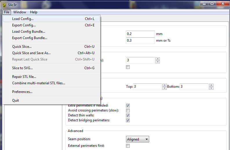

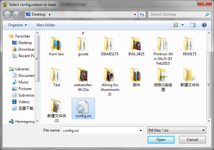

You can also load the configuration file too.
slicer config.zip
(1.27 KiB) Downloaded 3504 times
Open slic3r in Repetier Host:
import slicer setting 1.png (46.16 KiB) Viewed 71790 times

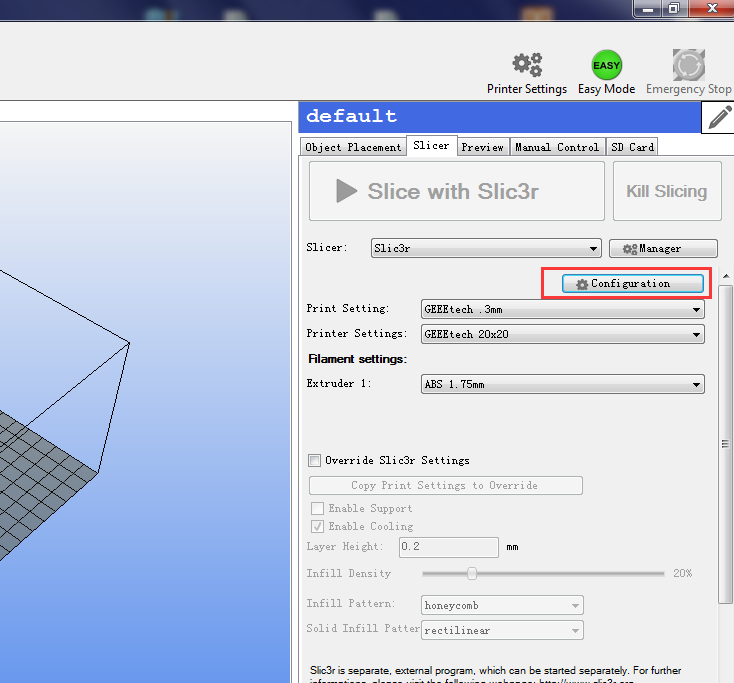

import slicer setting 2.png (52.58 KiB) Viewed 71790 times
import slicer setting 3.png (87.36 KiB) Viewed 71790 times
