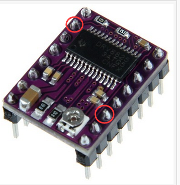

Connect these 2 pins if you want to turn switch No.2 on. As you can see in the picture:
connect MS2_VDD.png (150.61 KiB) Viewed 10774 times
Re: From home to 200, but X axis only moved 100
Posted: Mon Jun 01, 2015 10:51 am
by XYZM
Ok. That could work.
