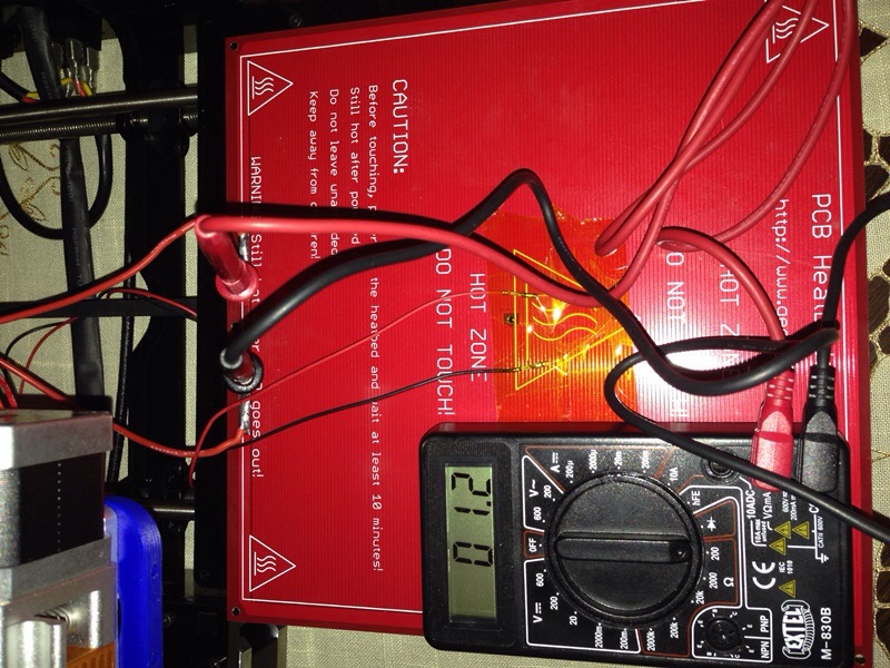

This is the value that I took with the meter set to 200ohm, see the attachment. I changed the battery tester to test more regularly so value supersedes last message. thanks to early

If the resistance you get is 1.2ohm, the hot bed is fine.

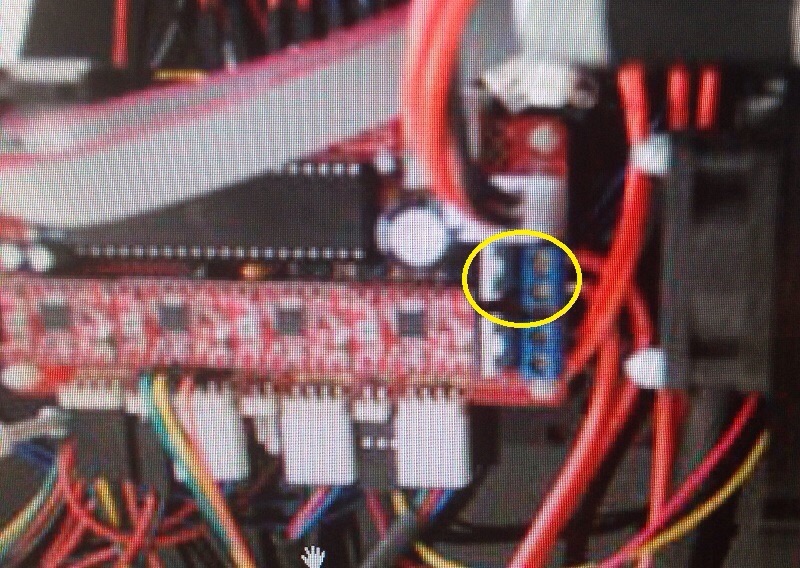

Post by Pgioy »
ok, mounting it runs as described in the manual page 57 Example 1 was added and the spacers between the structure and the board and the fan on the adjacent wall. thanks

Post by zhangxueyou »
Is the blue part close to the fan?

Post by Pgioy »
you, like you see in the picture, I saw it in the forum there was another person with my problem, but does not describe how it was solved. thanks
