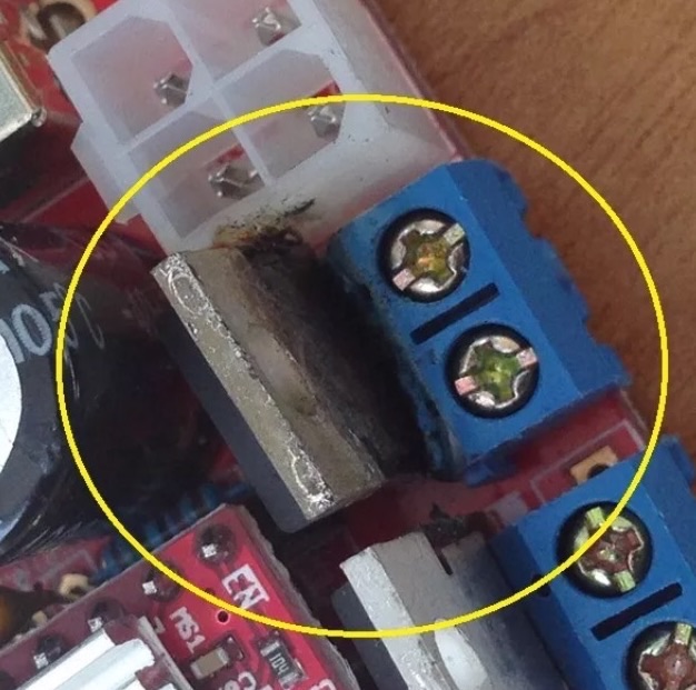

I put everything as how to explain the manual and following the configuration website geetech wiki, but at the time of giving the temperature at the heated plate has happened this as shown in the attached picture, the integrated tends to overheat and ruin everything, what You can do?

hello I just dismounted to see what has happened, I attacked on quell'innesto Heatbed as described in the manual, the problem is when I agree to give the temperature Heatbed, the MOSFET overheats the others are ok remain cool, I think that component is defective. for everything else works. hello thanks

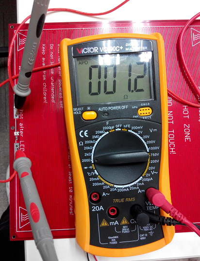

What is the resistance of heat bed?

the resistance of heat bed is 1k, to see attachment

1k ?! That's impossible. Normally it should be 1.2 ohm. How did you test the resistance? You can test the resistance at the 2 ends of hot bed wires.

I tested with my digital multimeter and reading me the value of 1k

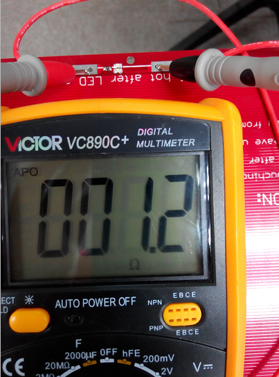

How did you test the resistance of hot bed?

ok, I just tested as photos and the value is between 0.45 and 0.60

Post by zhangxueyou »
That's abnormal with current double.
