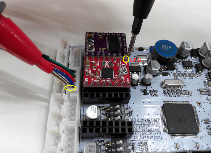

by zhangxueyou
The following picture shows how to test the voltage. Please contact the seller to tell them your issue.
And could you please tell me how is another extruder motor output voltage?
- how to test motor ouput voltage.png (633.52 KiB) Viewed 12545 times

by sogi
I tested voltage like shows on picture. Voltage on all four wires is 12,86V, when motors on extruder stopped or moving. Voltage on wires of axes motors varies from 0,17V to 3,65V, when motors on axes stopped or moving.

by zhangxueyou
I am a little confused by you. Is the 12.86V got from PSU?
When the extruder is moving , the voltage between GND and any pin of extruder motor slot is changing instead of a firm value, just like the axes.

by zhangxueyou
Let's check one more thing: Please check if there are 2 groups of 12V DC voltage from PSU when you turn on the printer. Please take a picture, show me how you test the voltage.
