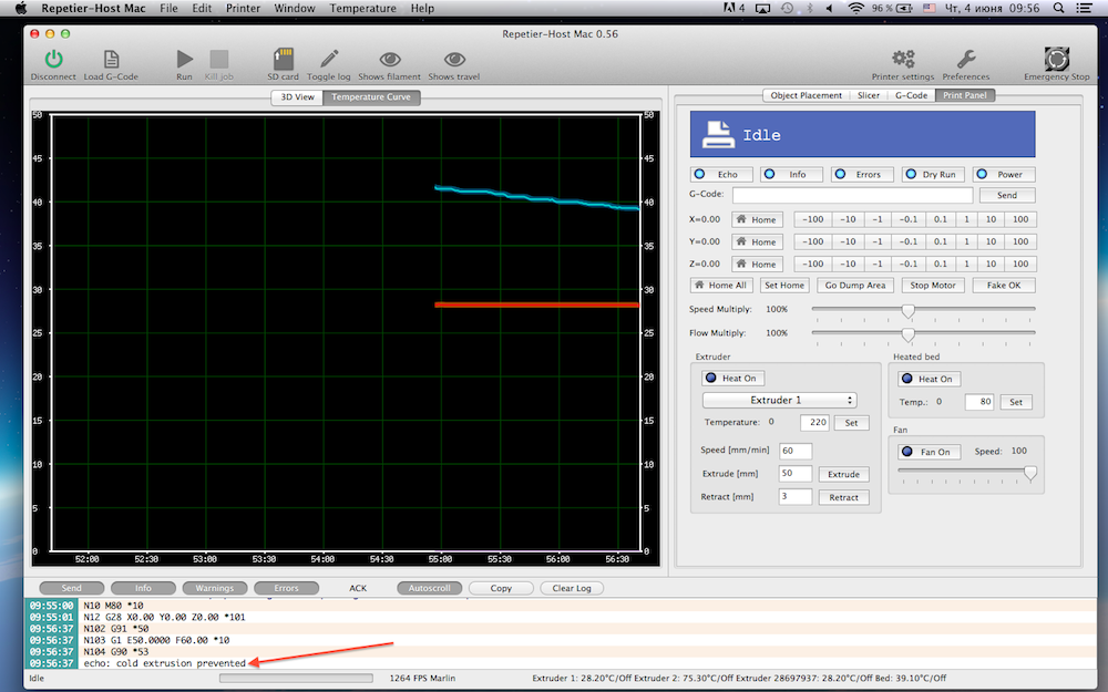

I use the Repetier host 0.56 on my Mac.
If I want to move extruder motor when temperature less than 170 degree, program say "cold extrusion prevented" and motor doesn't move.

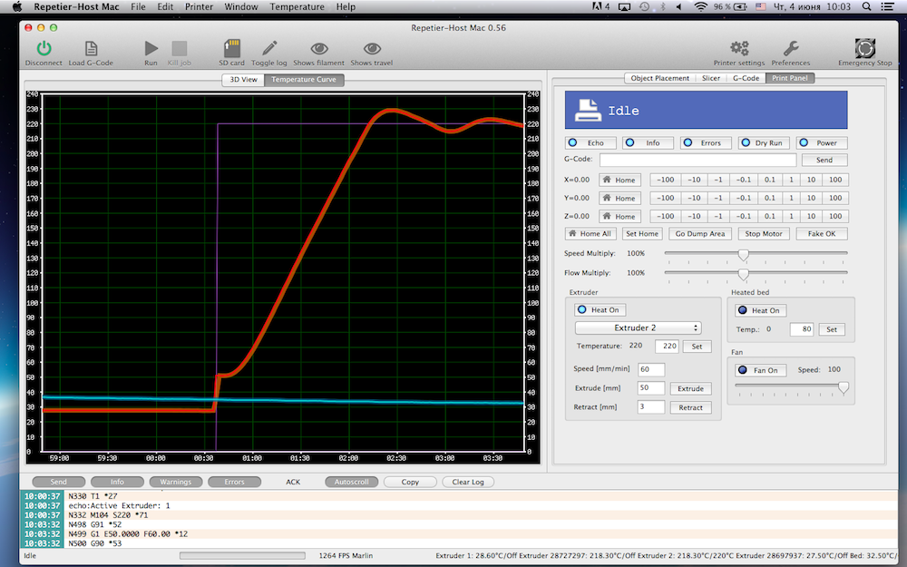

If I want to move extruder motor when temperature more than 170 degree, program says nothing and motor doesn't move.

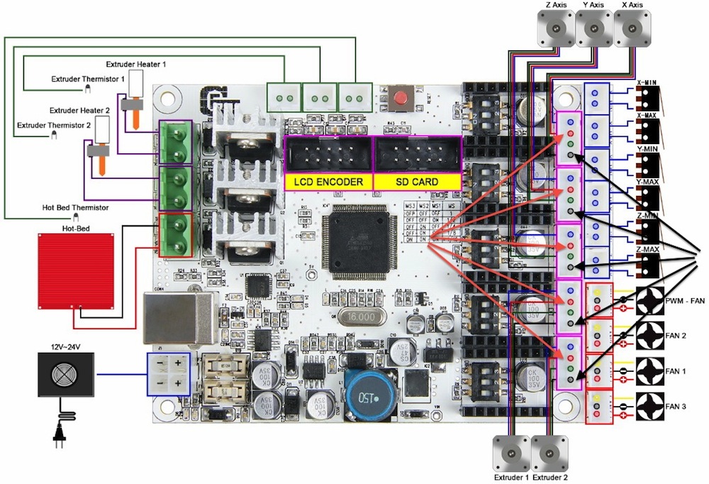

When I reconnect extruder motors on control board, motors are still stand (temperature on heaters is 220 degrees).
2-1 2.jpg (237.43 KiB) Viewed 16151 times
When I reconnect this motors to one of axes ports, motors are come alive.
I reconnected the heaters and them temperature sensor. This action only change in Repetier host Extruder 1 on Extruder 2 and Extruder 2 on Extruder 1, motors are still stand (temperature on heaters is 220 degrees).
2-1 3.jpg (237.65 KiB) Viewed 16151 times
When I want to control the printer from LCD-panel, I go to Menu-Control-Temperature-Nozzle1 (or Nozzle2) and set the temperature on 220 degrees. Then I go to Menu-Prepare-Move axis-Move 1mm-Extruder and twist the knob, motors on extruders doesn't work (temperature on heaters is 220 degrees). If I go to Menu-Prepare-Move axis-Move 1mm-Move X (or Move Y, or Move Z), motors works (on X, Y, Z axes).
With multimeter I checked Red and Black contacts on the control board. When I try to move X, Y, Z axes motors and stop them, this contacts have 12 volts. When I try to do the same action for extruders motors, contacts have 0 volts.
2-1 4.jpg (242.4 KiB) Viewed 16151 times
I reconnected the drivers of stepper motors - axes motors are works, extruder motors doesn't works.

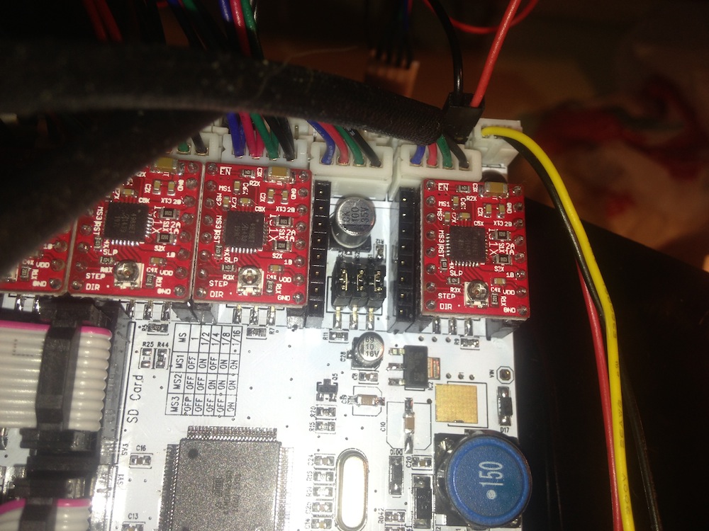

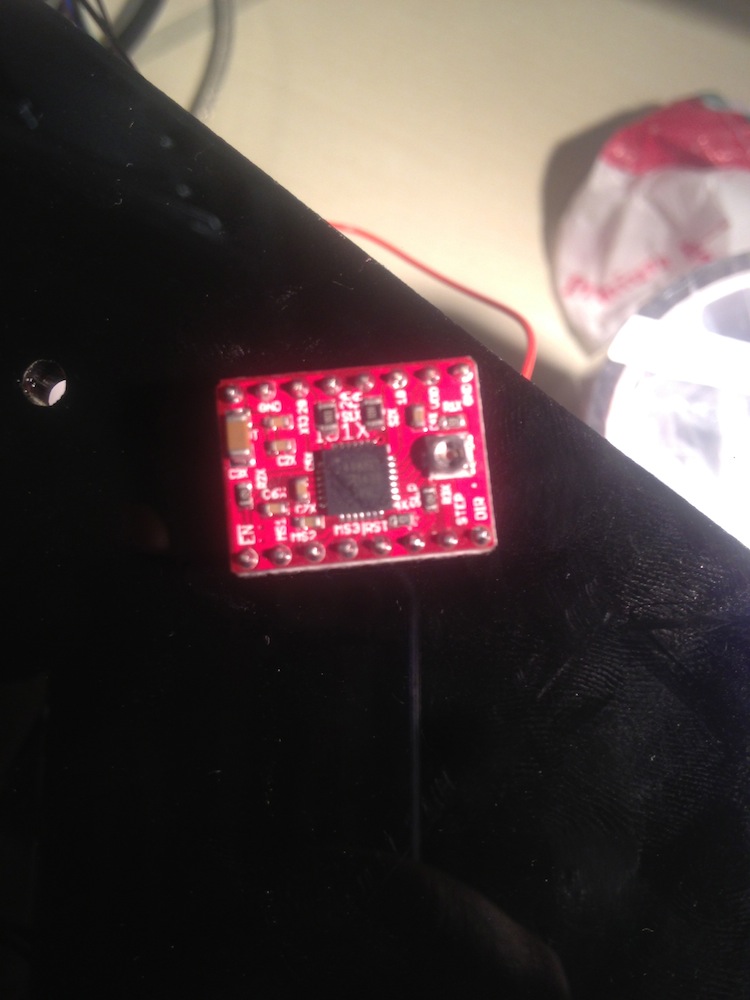

Hello. This is switches under stepper drivers
And this stepper driver
The motors doesn't work only if they connected to extruder ports, in other ports motors are works.

How about swapping the extruder motor driver with x or y motor driver? If it moves, the extruder motor driver is dead.
If it still not moving, please try to re-upload the firmware. The firmware has been sent to your email.

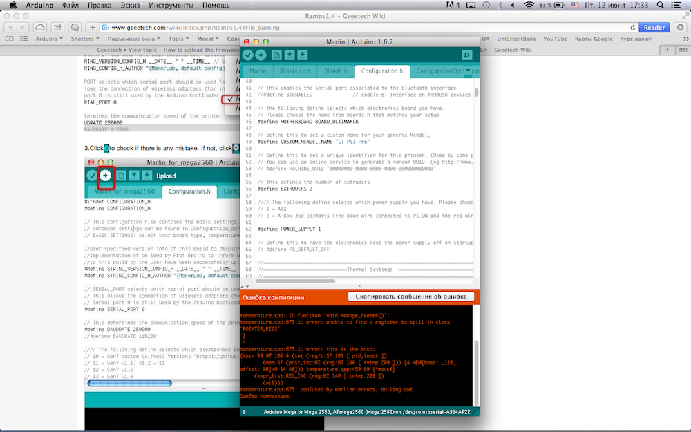

When I want to reinstall the firmware, Arduino says
Снимок экрана 2015-06-12 в 17.33.21.png (377.83 KiB) Viewed 16126 times
zhangxueyou
Posts: 1405
Re: Motors on extruder doesn't work
Post by zhangxueyou »
Please try to upload with Arduino 1.0.1:
http://www.geeetech.com/wiki/images/c/c ... or_Mac.zip
