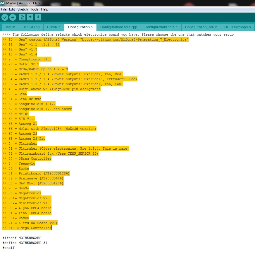

what I mean is: if you open the firmware you sent me in Arduino, click on the tab Configuration.h
you will see these options of Main Boards (See picture)
Main Bord
Main Bord
as I wrote earlier, 7 = ultimaker was the stock setting?
I just wonder if not 34 = RAMPS 1.3 / 1.4 (power outputs: Extruder0, Extruder1, Bed) would be a more appropriate setting because my power outports applies to this option?
