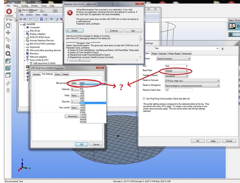

immediately when Repetier Host is newly installed, I can connect and temperature of the heat bed and extruders are shown but nothing works ...
no preheating, no stepper motor or extruder works, no fan and no auto-leveling.
but as soon as I unplug the usb and connect again, I get:
"The given port name does not start with COM/com or does not resolve to a valid serial port.
Parameter name"
Baud rate?
Baud rate?

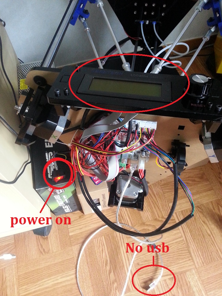

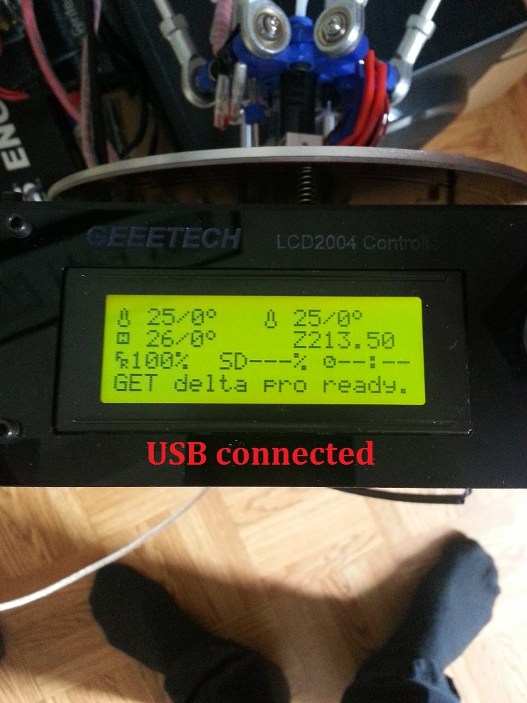

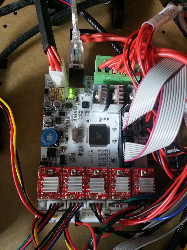

LCD display only works when the USB cable is connected to your computer

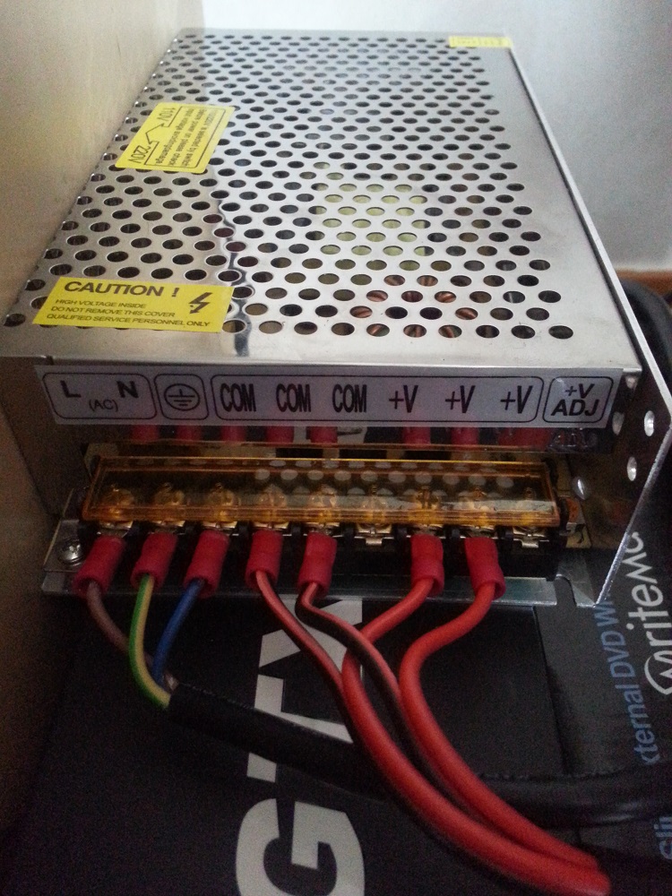

If i have the power unit on or off makes no difference?
LCD dead
LCD dead
LCD on
LCD on
too low V +? or bad firmware
Power unit
Power unit
GT2560
GT2560

hi,my apology for delay in responding.According to you description,the firmware is ok.Maybe the psu have problems .so,the lcd could not read anything with no power.now,please check the fuse and psu output voltage.
1.Measure the output voltage of psu.The output voltage should be 12V.
2.Check the fuse on the board.if the fuse is burned out.

Ye it was the PSU, i had connected it wrong ... embarrassing but true :roll:
