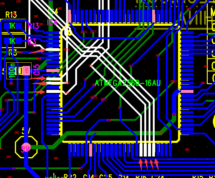

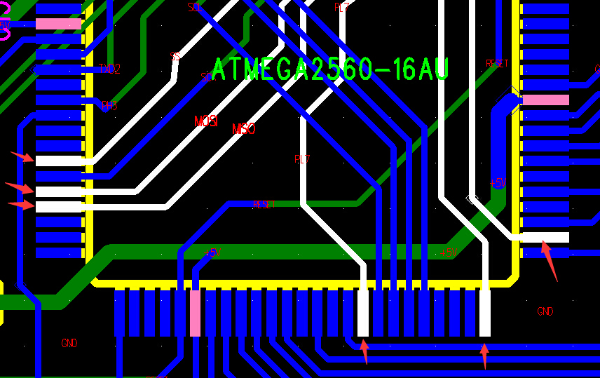

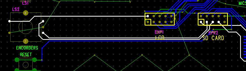

might check the pads on the LCD panel, see if there's bad soldering or short out there:
or the pins of the mainchip, related to the SD card and knob function here:
LCD 2004 pin SD card.jpg (427.47 KiB) Viewed 8213 times
LCD 2004 pin LCD.jpg (609.02 KiB) Viewed 8213 times
