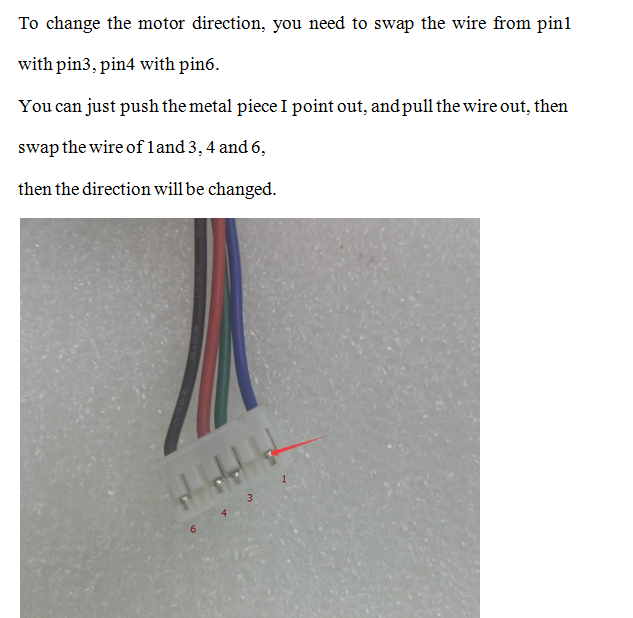

Prusa I3 up and running. All motors checked and running when connected, except Z axis right hand motor runs in opposite direction to left hand - even when swapped round. Forum shows masses of downloads to cure this. Any very simple solutions please?

Modify the wiring order may cure it:

I can confirm swapping the plugs like this works to reverse the direction of the stepper motor on all axis.
Will come back here to confirm the printing is also works like it should and is not reversed or mirrored in any way

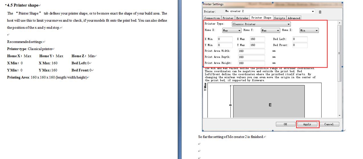

But when I print, he stay at the left instead of the center.

Hi,Not printing in the center of the bed,there are two possibilities:
1)Did you have a right setting in Printer Settings?
file (1).jpg (68.23 KiB) Viewed 31494 times
2)Was the size of the actual printing the same as the size of your model?If it wasn't, maybe the step/mm of
your motor is wrong.
