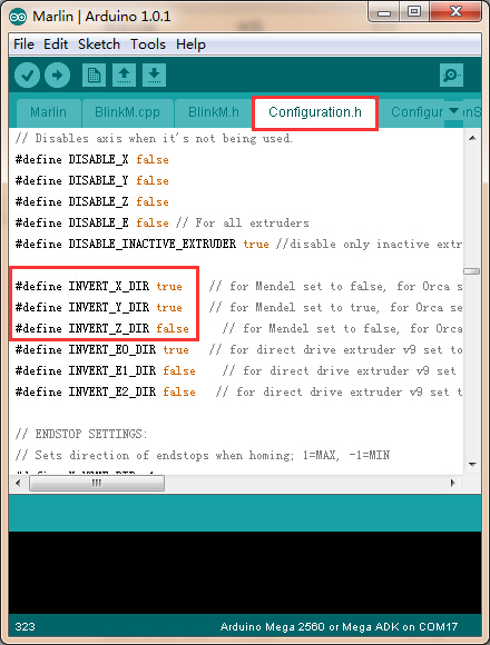

(1)Axes go to wrong direction
Power on the printer, home the printer, see if all the motors run in the correct direction. When homing, all the axis will move towards the endstop, trigger it and then stop. If you cannot home the printer, then manually move the X Y Z motor one by one, see if it goes in the right direction as you told.
If not, for board GT2560/Sanguinonolu etc. that using the firmware based on arduino, change the corresponding settings here in the configuration.h tab of your firmware and upload it to your printer. And ready to hit the emergency stop button if necessary!
Note: you might need to install the firmwar twice cause you don't know it is true or false in the first place.
#define INVERT_X_DIR true // for Mendel set to false, for Orca setto true
#define INVERT_Y_DIR false // for Mendel set to true, for Orca set tofalse
#define INVERT_Z_DIR true // for Mendel set to false, for Orca setto true
#define INVERT_E0_DIR false // for direct drive extruder v9 set to true,for geared extruder set to false

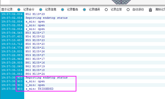

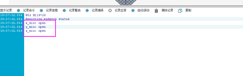

If only one axis endstop is not working, and the axis hit the endstop but not stop and make some noise. the endstop may be broken. you can have a check.
Power off the printer, manually put the 3 stepper motors in the middle of their axis, it will allow you to press the emergency button in time if something wrong happened. then power on your printer, the connect to your computer, and open Repetier Host input G-code:M119.
then your log will show as follows.
then press endstop with your end. here I take Z axis as a example. If Z axis endstop changes from "open" to "TRIGGERED", the endsop is OK, if it is still "open", there is problem. you can swap a good endstop with Z axis endstop. If the new endstop can work now, you need a new endstop.

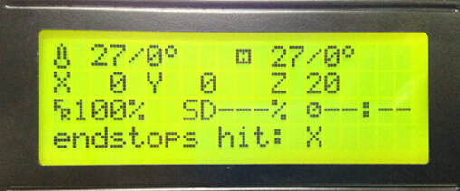

(4).Endstops hit error
endstop hit.jpg (157.52 KiB) Viewed 111472 times
Firstly,check if the corresponding endstop has a good connection to the board.
Secondly,if one of your axes is having this problem, that’s because the endstop direction is wrong, you should change the corresponding direction here in the tab configuration.h in your firmware:
// The pullups are needed if you directly connect a mechanical endswitch between the signal and ground pins.
const bool X_MIN_ENDSTOP_INVERTING = false; // set to true to invert the logic of the endstop.
const bool Y_MIN_ENDSTOP_INVERTING = false; // set to true to invert the logic of the endstop.
const bool Z_MIN_ENDSTOP_INVERTING = false; // set to true to invert the logic of the endstop.
const bool X_MAX_ENDSTOP_INVERTING = false; // set to true to invert the logic of the endstop.
const bool Y_MAX_ENDSTOP_INVERTING = false; // set to true to invert the logic of the endstop.
const bool Z_MAX_ENDSTOP_INVERTING = false; // set to true to invert the logic of the endstop.

I bought the Delta Rostock Mini G2s Pro and when I try to home the printer both my x-axis and z-axis go downward while my y-axis goes up rather fast and ends up hitting the rods unless I emergency stop. I've tried setting the directions in the firmware:
Code: Select all
#define INVERT_X_DIR true // DELTA does not invert
#define INVERT_Y_DIR true
TO:
#define INVERT_X_DIR false // DELTA does not invert
#define INVERT_Z_DIR false
This doesn't seem to fix the problem, they still move the same way, X and Z axis going downward, Y axis going up.
What does it mean in the firmware "// DELTA does not invert", does this mean you cannot reverse the stepper motor direction in the software? If so, how do I reverse the motors?
Thanks...
try this one agian, usually you don't know it is true or false in the first place,so you'll need to try the second time.

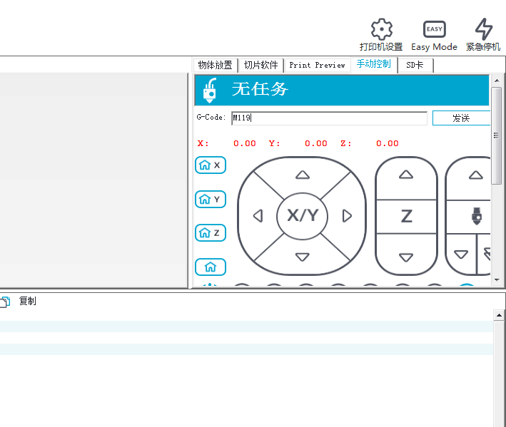

Did you plug the endstop in the correct position? And how about swap the working endstop to the Y axis or Z axis, could it be the endstop is defective or open circuit?
Also you can check the endstop status with the M119 command.When the endstop is released, send M119 it will report "open"; and when it is triggered it will report "triggered"
