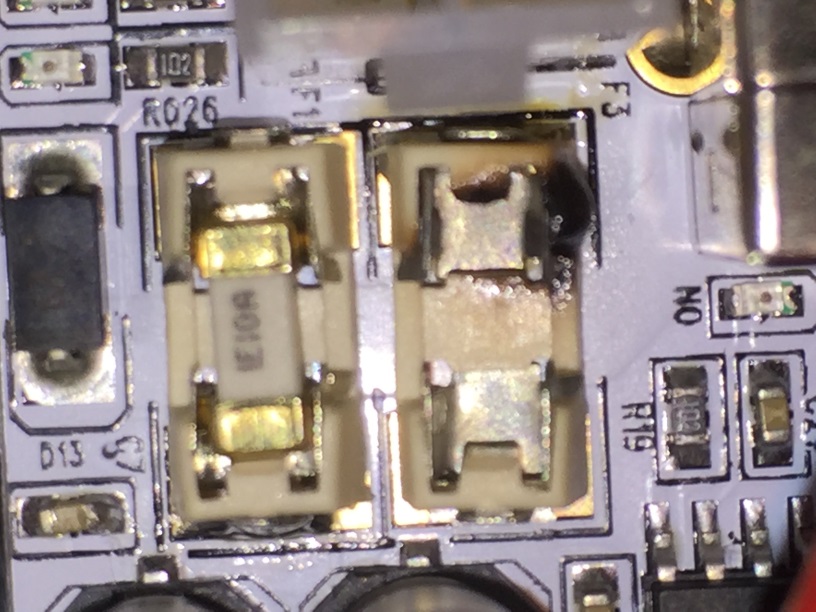

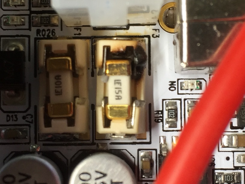

I purchased my Geeetech Aluminum Prusa I3 A Pro 3D printer & 3-in-1 control box on EBay from "geeetech-official" (Order #232045068959) and received it on March 3rd. So far I have printed about 0.75 kg of PLA filament. Yesterday my Hotbed stopped heating. When I took apart the control box, I discovered that the 15 Amp hotbed fuse connector was burnt. The fuse is ok, but connector is burnt. The connector is surface mount to PCB, so I can't solder on a new one. I have sent e-mails to the EBay seller "geeetech-official" and Geeetech Order Service. Is Geeetech willing to send me a replacement GT2560 control board? How can I repair the printer?
Burnt Hotbed Fuse Connector
Burnt Hotbed Fuse Connector 2.jpg (131.17 KiB) Viewed 32182 times
Burnt Hotbed Fuse Connector.jpg (155.34 KiB) Viewed 32182 times
