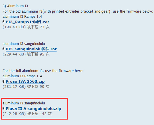

I am still a bit confused as to which firmware to use on my printer?
I have the Geeetech Aluminum Prusa I3 3D Printer kit
http://www.geeetech.com/geeetech-alumin ... p-944.html
Thank you
Re: firmware for geeeteh 3D printers
Posted: Mon Dec 28, 2015 4:07 pm
by Mark
use this one:
