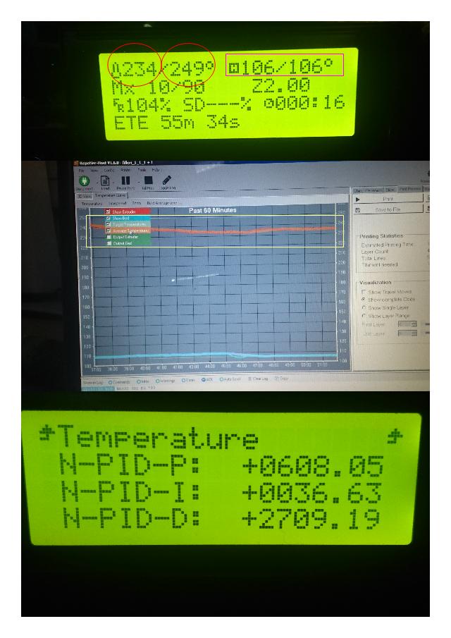

- bad_last_1.jpg (67.88 KiB) Viewed 20580 times
In picture 1(bad_last_1) hotend don´t keep setting temperature 249ºC and also Repetier-Host picture shows how hotend temperature is wondering.
Also there is N-PID settings. It is nice to have manual for all the LCD setting.

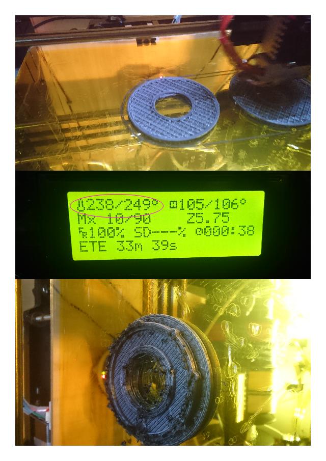

- Bad_last_2.jpg (79.28 KiB) Viewed 20580 times
In Picture 2 (bad_last_2) There is object when hotend is near bed. Everything goes fine because also bed is warming hotend.
In midle is printing least at 00:38 temperature hotend is still under setting 249ºC.
When hotend temperature goes down start glogging in extruders. Hotend can´t melt ABS. It is bad for A9488 and motors. Fortunatly i lost 2pcs orginally A9488 but 0pcs motors.
In bottom have print result. Not look nice.
I am not pleased this kind printing results. Cleaning hotend after every printing . Buying new A9488.
Now i been waist nearly 1kg roll filament to have nothing.
