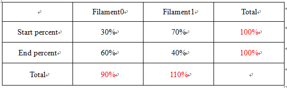

1. All the settings are set based on Filament0 by default.
2. According to the work principle of Mixer, the sum feeding rate of Filament0 and Filament1 is 100%. After Filament0 is set, the system will automatically calculate the corresponding feeding rate of Filament1.
3. Start percent and end percent can be set at will. The sum of them is not always 100%. Users can adjust it according to their requirements.
E.g., you can set the start percent of Filament0 as 30% and the end percent 60%.
4. Start height and end height are print heights above the bed not the current printing height. Start height and end height must be greater than current printing height, otherwise they will be regarded as invalid. For example, current height is 40mm above the bed, but the start height in the template setting is 20mm and the end height is 30mm. It has overlapped part with current print height, so the system will automatically ignore this template and continue printing with the current template.
5. When one templates is finished, printing will continue with the feed rate percent that is fixed, without gradient effect, until you choose a new template.

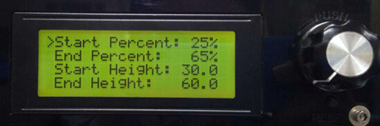

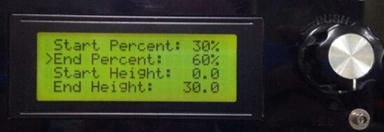

2.2 Custom Template Setting

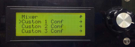

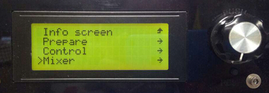

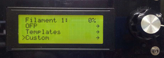

1 Open Mixer->Custom on LCD control panel:
Let’s take custom 1 as example.
Here we set custom 1 conf as follows:
Start Percent: 30%
End Percent: 60%
Start Height: 0mm
End Height: 30mm

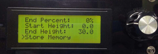

When the setting is done, please press Store memory to save it:

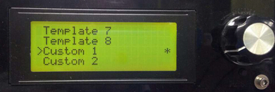

The templates which have been set can be found in Mixer->Templates.
You can change setting parameters at any time during the printing process. When the setting is done, you can start printing. Select the corresponding template in Mixer-> Templates during the printing process.
Note: the“*” after the template means the current template you are choosing and using. System will follow your last chosen operation by default.

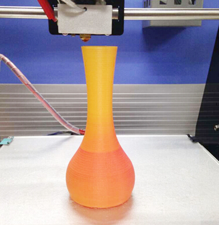

Ⅲ. Printing Effect Demonstration
The following picture shows the printing effect after the combination of Custom1 and Custom2.
Filament 0: red;
Filament 1: yellow
