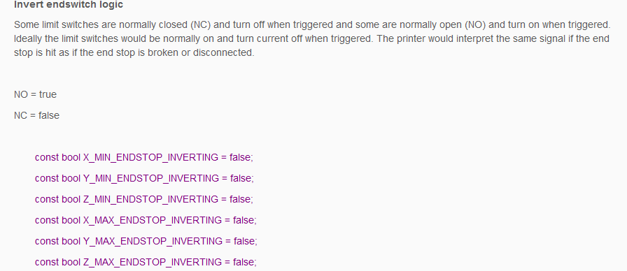

Have a look at the pic i post to see if it will help:

// The pullups are needed if you directly connect a mechanical endswitch between the signal and ground pins.
const bool X_MIN_ENDSTOP_INVERTING = false; // set to true to invert the logic of the endstop.
const bool Y_MIN_ENDSTOP_INVERTING = false; // set to true to invert the logic of the endstop.
const bool Z_MIN_ENDSTOP_INVERTING = false; // set to true to invert the logic of the endstop.
const bool X_MAX_ENDSTOP_INVERTING = false; // set to true to invert the logic of the endstop.
const bool Y_MAX_ENDSTOP_INVERTING = false; // set to true to invert the logic of the endstop.
const bool Z_MAX_ENDSTOP_INVERTING = false;
I don't have never ''triggered'', always ''open''.

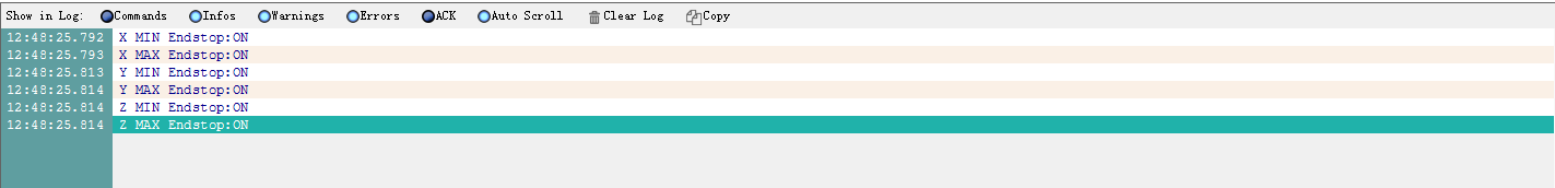

Could you plz attach a pic of the status after your inputing M119?Home your printer firstqdshombre wrote:// The pullups are needed if you directly connect a mechanical endswitch between the signal and ground pins.

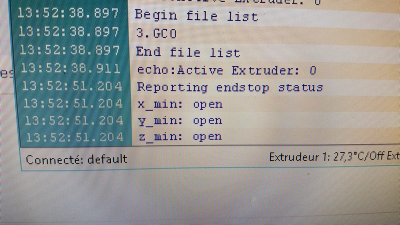

Did your sensors of all the axis touch their own endstop???if they did,there should be "on" or "triggered" not "open".You haven't home them fully???If you didn't,manually move them to the endstop position then input the "M119" to see what happens.If you did,check the connection between the endstop and the endstop's connector on the motherboard.qdshombre wrote:
Re: Z home with autolevel
04:59:52.037 : x_min: TRIGGERED
04:59:52.037 : y_min: TRIGGERED
04:59:52.037 : z_min: open
I have with X and Y, not for Z
