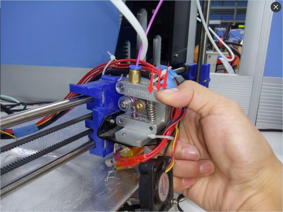

OK,you can check the following 2 points:
1.Uninstall the fan of extruder,then press the handle,move E axis(drive the extruder) on software or LCD and observe if the extruder's rotating speed is normal:
2.Observe the gap between the philip screw and the gear when extruder moves,make sure the gap is not too tight or too loose.Also,you can check what is the main reason actually that affects the speed of sending filament when the extruder works:

Hi,my friend
I do remember it.But what i actually wanna you do is to check if there is a problem on the extruder itself by referring to the earlier version MK8.Like the gap between the screw and the gear,and you can check the extruder motor's speed after you pull out the filament.Remember to remove the fan of extruder.
