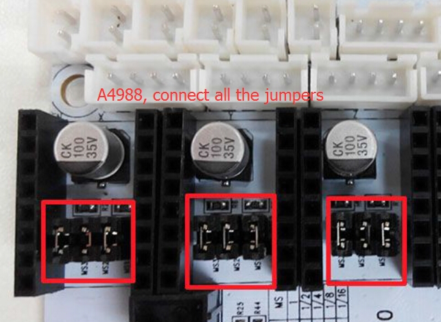

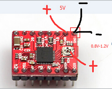

Did your motor of extruder move abnormally?
1.Make sure all the jumpers should be plugged in.
2.Normally the value should be 0.8V-1.2V.If the voltage is too low or too high, the step motor will not work stable. It will lose steps or vibrates, sometimes too hot. You can rotate the potentiometer on the driver to adjust the voltage to about 1.0V and see it if works.
