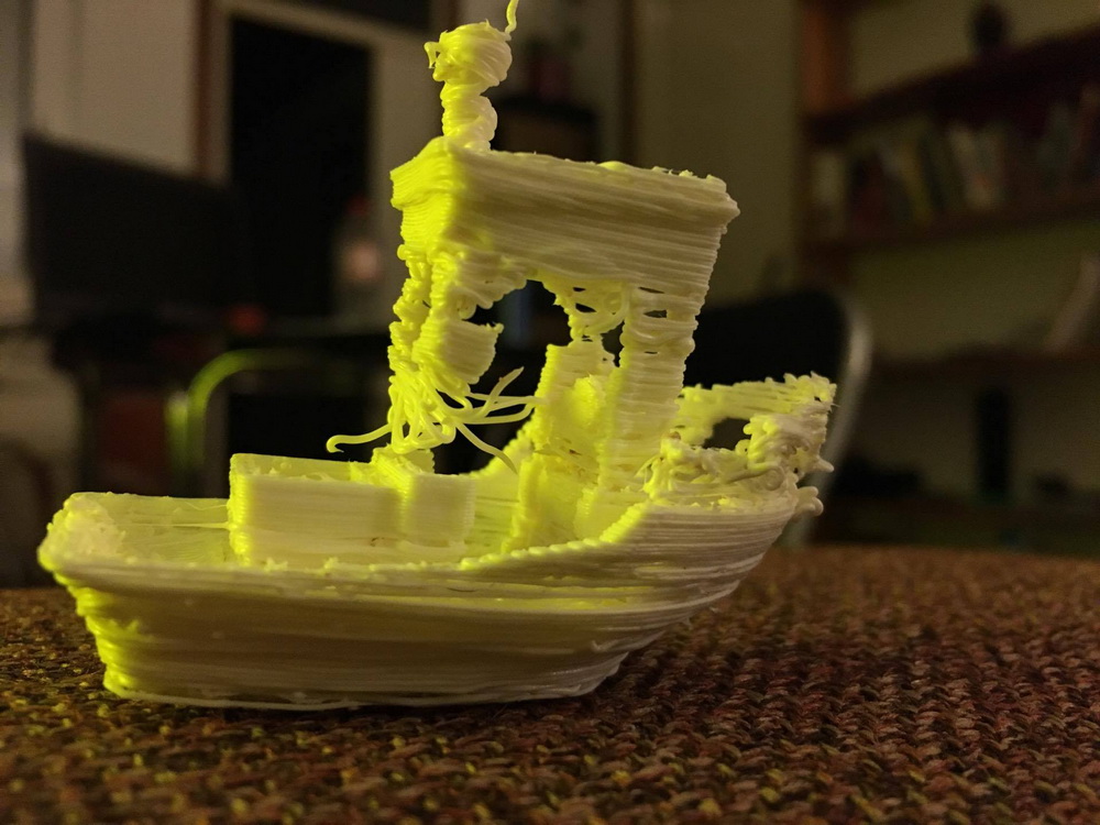

Benchy boat
Benchy boat
It seems i have managed to get it to print with the ABS.
It's very low quality. It seems to be working if i manually push the filament until it gets the flow going then it starts to print but after some time it just gets stuck... with the same settings and everything that was working perfectly it suddenly stops extruding. I also have some air bubbles forming in the hot-end but it has worked while the Filament was popping.
Also sometimes the filament worked smoothly and perfectly at 257, then lowering the temperature at 251 would get it working again.
I haven't experienced any bad /sever warping or part getting unstuck after boosting the heatbed to 115 but. it seems it takes a long time to get to that temp ( after aprox. 100 it goes 1 degree/minute).
I think the filament might be bad tho but i want to give it a few more tries before requesting a refund.
