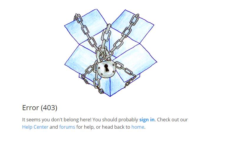

Re: Prusa i3-B Problem Printing ABS
I get this when i click your link,you can post a Youtube link i guess:

Sorry here is the correct Link, https://dl.dropboxusercontent.com/u/300 ... 2%20PM.mov
