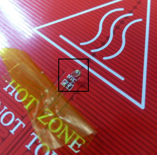

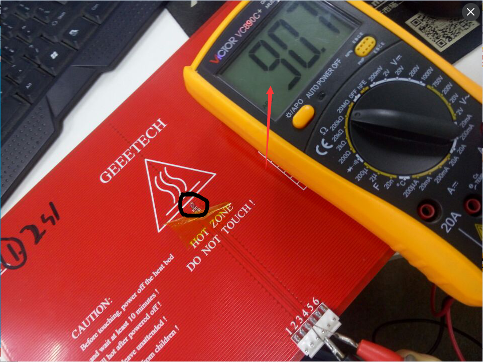

So did you check the thermistor underneath the heat bed?See my picture:Haralds wrote:Hi!

Could you take a picture of it like mine?Haralds wrote:Yes! I check it. Both wires are alive.
Haralds
At the same ,you can measure the resistance of your bed thermistor,whose value should be about 100K ohm.

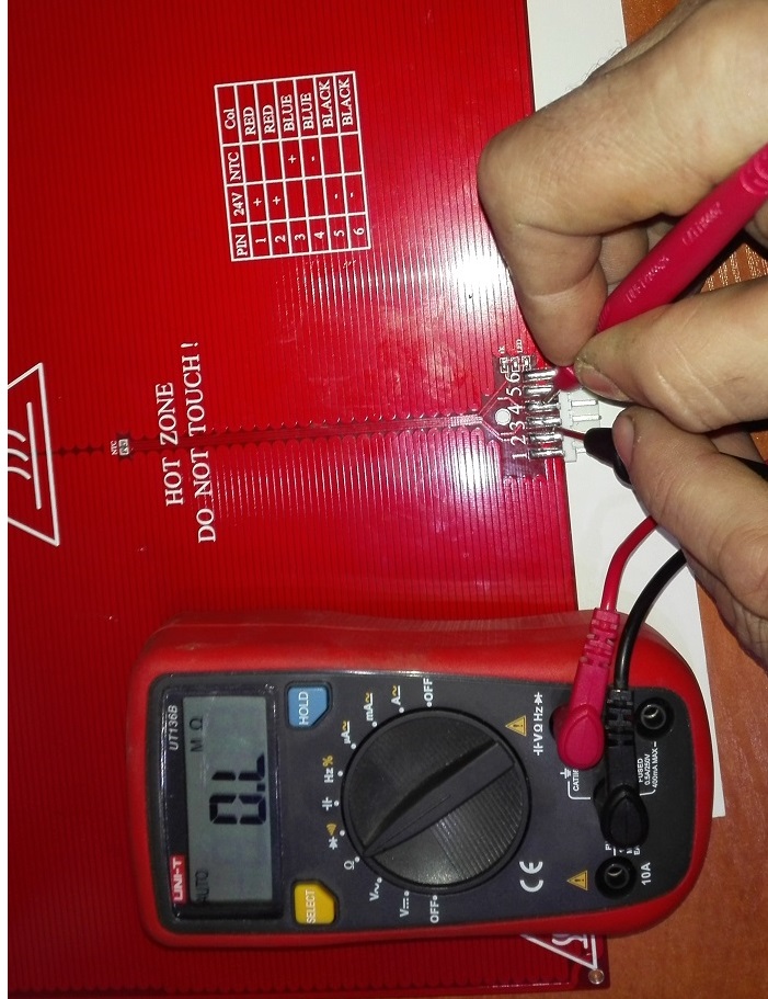

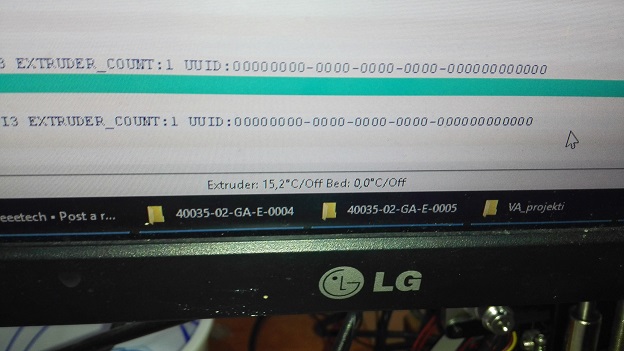

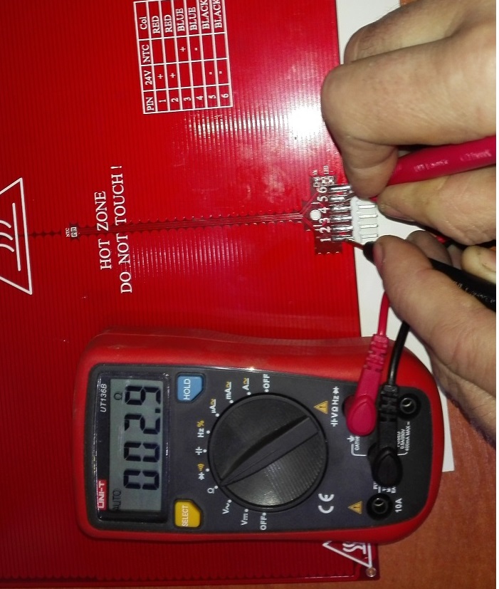

Hi there is pictures.
Resistance measurement shows there is no connection.
With original wires, attached too and measured directly too.
Haralds
Haralds
- IMG_20161104_082754 a.jpg (153.06 KiB) Viewed 8964 times
- IMG_20161104_082758 a.jpg (74.08 KiB) Viewed 8964 times
- IMG_20161104_082850a.jpg (203.09 KiB) Viewed 8964 times

Hi,Haralds
Sorry i didn't find the thermistor in your picture.Was it missing?
Tear out the tape on the bed so you can measure the resistance from the 2 pins of the thermistor directly.
You know what,i'm suspecting the thermistor is a bad one or it wasn't solder well...

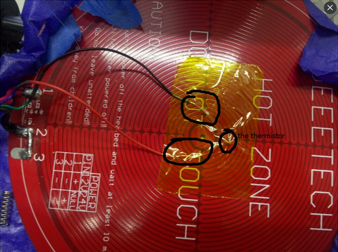

See my picture:
See my picture:
Re: Printer still is not working

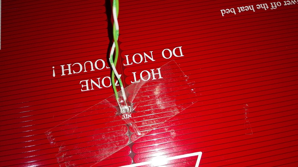

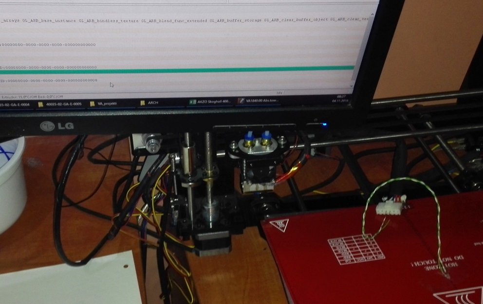

Hi!
There are measurements
- IMG_20161104_092009.jpg (172.82 KiB) Viewed 8964 times
- IMG_20161104_091954.jpg (205.09 KiB) Viewed 8964 times
- IMG_20161104_091924.jpg (268.49 KiB) Viewed 8964 times
So you don't have this stuff(thermistor) on the surface of your bed?Or you unplugged it ?
I do nothing with it.
It is as was at delivery time.
I thought that it is integrated in the bed inside...
If it should be on surface then it never was there.
So what is Your sudgestion? What I should say to seller?
Haralds
Haralds

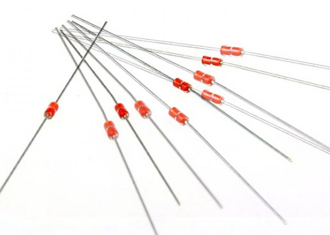

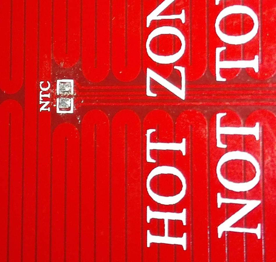

Yes,Haralds
You should tell your seller about it and let her resend a bed thermistor with previous broken stuffs together.
You can solder it on the two solder joints underneath the bed when it arrives.
Finally we find the problem,the thermistor is used to detect the bed temp,but it was missing and that's why you get "0/0" for bed on LCD.
