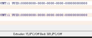

Re: Printer still is not working
Hello!
I checked the f I short the termistor end on board repieter shows 301 deg.C.
On heated bed I don't see any damages or disconnections.
Sorry but You didn't say anything about heating of heated bed.
What is about it?
We have following facts:
1) resistance of heated bed is out of specification.
2) heated bed is not heating even if it is connected to boards hotend heater.
3) hot end doesn't heat if I connect it in place of heated bed. In case if board is in order hot end should heat up but it doesn't happen.
So my assumption is following:
1) that hot bed is dead at all;
2) probably there is some problem with board too.
Haralds

- On board Shorted bed termistor.JPG (19.41 KiB) Viewed 9946 times
1.
2.
And one point you'd better get is: only the board detects the bed temp(room temp) can the heater heat up,but in your case there is no temp detected.
This suggests the T_bed slot on the board is OK,so the board doesn't have a problem.I checked the f I short the termistor end on board repieter shows 301 deg.C.
2.
It's not the bed,but the thermistor underneath the bed.Maybe the thermistor wasn't soldered well(has an open circuit),or it was broken.1) resistance of heated bed is out of specification.
