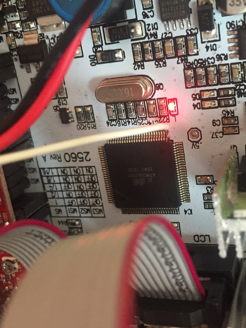

Re: 3d touch sensor g-code and endstop issues
fixed it.... Just solder the signal (orange cable) to the R22
And now it works like a charm!
Now calibrating time!!!
- R22
- Foto 07-05-17 16 24 36.jpg (235.07 KiB) Viewed 28129 times
