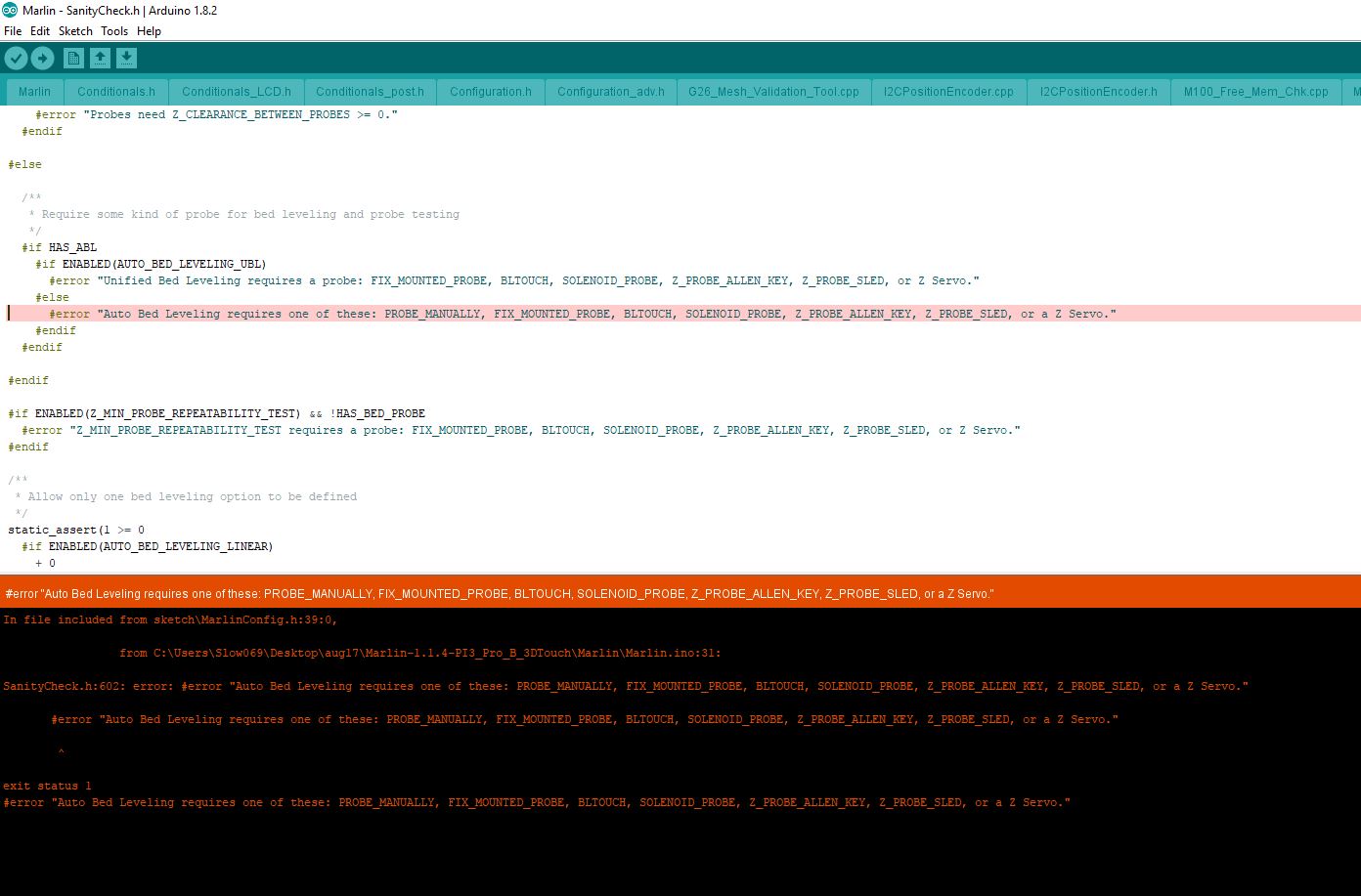

I am trying to install this new firmware to my GT2560 rev A board
how ever I am running into errors when verifying the settings I have changed to accept a proxy switch for the auto bed leveling not a BLtouch
below is the error field would be nice if you can assist in this issue

steveski21 wrote: Sun Aug 20, 2017 5:37 am Hi Niklas0
Hello, you should use the Arduino IDE 1.0.1 Version.

Re: Latest stable Marlin for Geeetech i3 Pro B
Maybe you should use the Arduino IDE 1.0.1.
