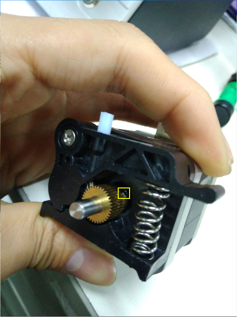

I have cleaned the gear from the motor on the top. Still not working as it should be.
If i press the handle a little up. The filament goes how it should be.
Anyone a tip??

The pressure of the filament was good. Sinds yesterday the gear doesnt pick the filament well.
If i lift the handle on the top a little, the filament goes as it should be.
This have nothing to do with the voltage right???

Maybe you should check if the screw of the gear has been firmly fixed

thanks for all the reactions, i have found the issue
it was a part next to the gear, the plastic what was holding the roller was broken.
dont know if it is the correct name.
