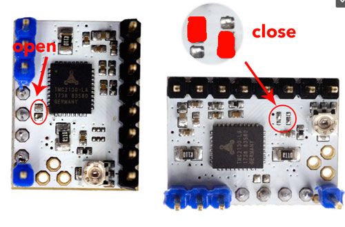

Hi all, I'm going creazy.
I've bought TMC2130 from Watterott and also from Cina (Fysetc 1.0) but I' get only "driver error"... I want to ask:
- Do I have to remove the jumpers on the motherboard (MS1, MS2, MS3) ?
- The following setup (open, close, close) is right? for Watterott and for Fysetc I mean...
[attachment=0]tmc2130_config.jpg[/attachment]
Thanks in advance, Lucio
- tmc2130_config.jpg (44.93 KiB) Viewed 21789 times

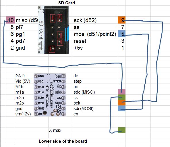

A small schema I've made so far for cabling

Your picture is for Fystec v1.0. Would have been more simple to buy the v1.1 version for SPIicelucio wrote: Fri May 18, 2018 3:21 am Hi all, I'm going creazy.
- The attached image (open, close, close) is right? for Watterott and for Fysetc I mean...
To change from 1.0 to 1.1 you need to open the soldered short cut and to add 2 super small solders
