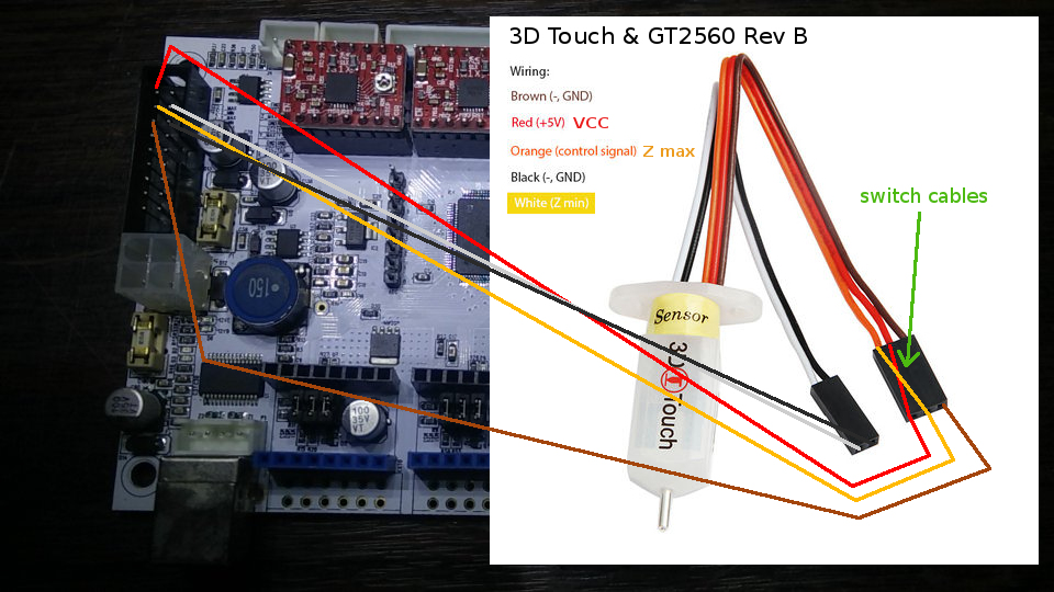

Please... can U show us a complete working setup? No mistakes, please. I am confused now.
This image is from http://www.geeetech.com/wiki/index.php/ ... ing_Sensor:
This is the board:
So... can U please show EXACTLY how to connect? Don't change colours.

You have to exchange red and orange.

So it looks like:
Code: Select all
Endstop connector:
VCC [red]       |   VCC
Z_MAX [orange]  |   Z_MIN [white]
GND [brown]     |   GND [black]
VCC             |   VCC
Y_MAX           |   Y_MIN
GND             |   GND
VCC             |   VCC
X_MAX           |   X_MIN
GND             |   GND

Here is a picture of correct wireing:
Have fun!
