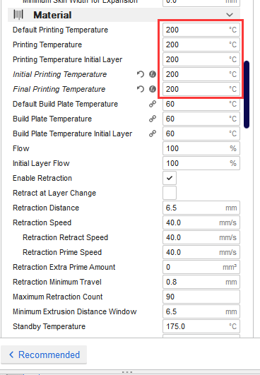

hi,
I have an A10m and seem that work fine, but when print two color with cura, the printer fail... print correctly only first layer whit two color, than it crash with fail heating error.

Hi,paolo.f
I think you can refer to these pic then set the temp of it to 200C
Heating error-1.png (35 KiB) Viewed 16032 times
Heating error-2.png (23.76 KiB) Viewed 16032 times

by paolo.f
nice, this evening I'll try this setup.
Re: Cura json file for your Geeetech A10M printer
Posted: Sat Apr 13, 2019 10:54 pm
by paolo.f
ok, I tryed again and now seem that all work well, only need some adjusting for cleaning extrusion when change color.
