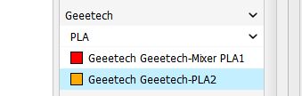

Re: Cura json file for your Geeetech A20M printer
Hi -
After downloading and extracting the Geeetech Mixer PLA Profile - there are two files But after importing the files the PLA2 is missing the 'mixer'
It appears from the screen shot in the instructions I should have two mixer files. I tried removing them from Cura and then importing again with the same results. Any suggestions?
